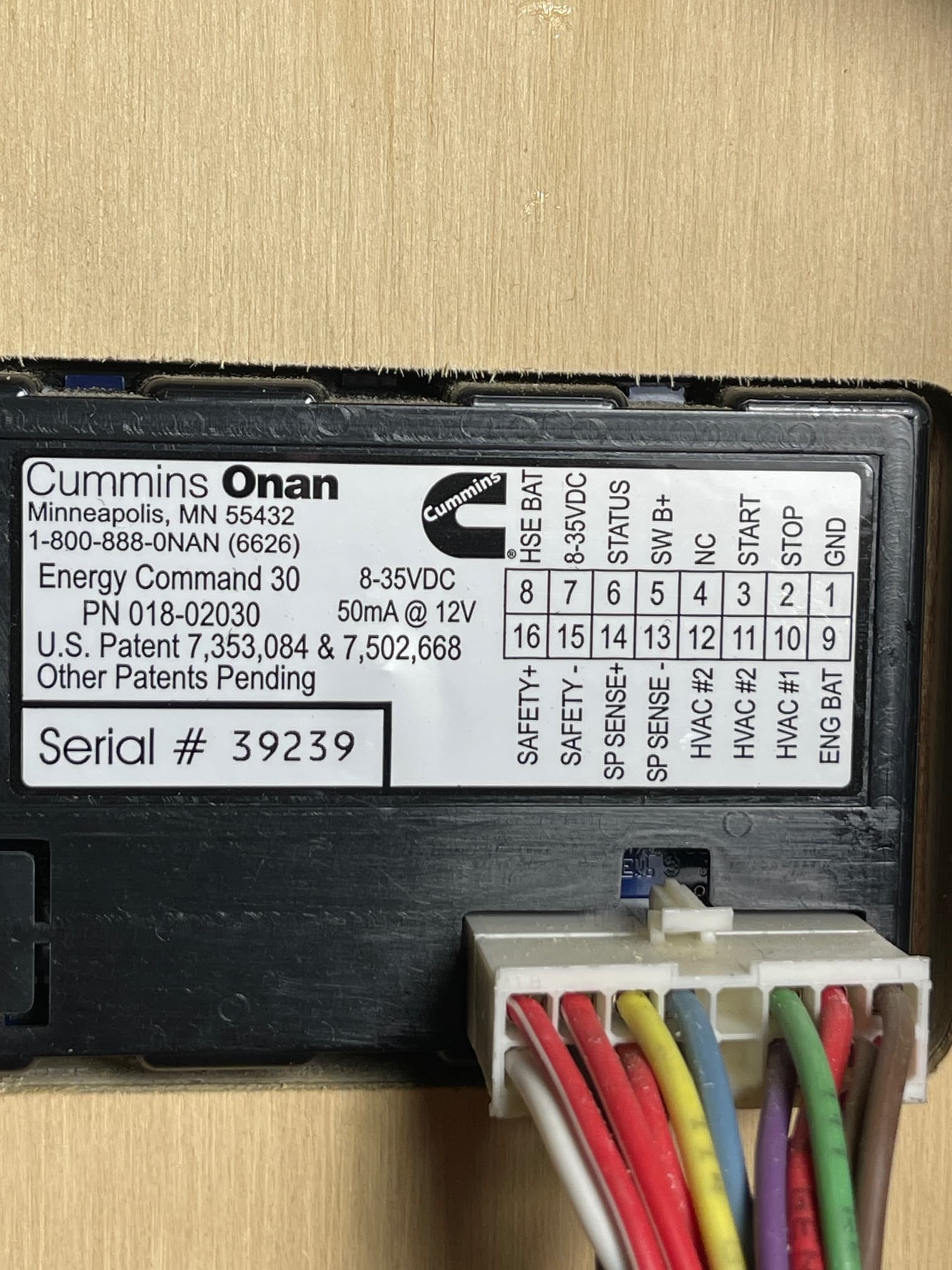

This is a brand new setup replacing the ME-MS2000 Inverter with Cerbo GX Mk2 start-stop Onan RV QD 8000 Genset with Multiplus-II 2x120V and SmartSolar MPPT 250/100 and Lithium Batteries. I have heard there is a simple way to run two or three wires to my diesel Onan to control start stop run functions using Cerbo GX Mk2 relays, instead of adding 2 external GRT8-M1 relays via the Multiplus-II. The Onan Energy Command 30 is still in place but not recommended for AGS functions.

Is this 3 wires spliced into C-A-E pins or do I need to add switch/relay?

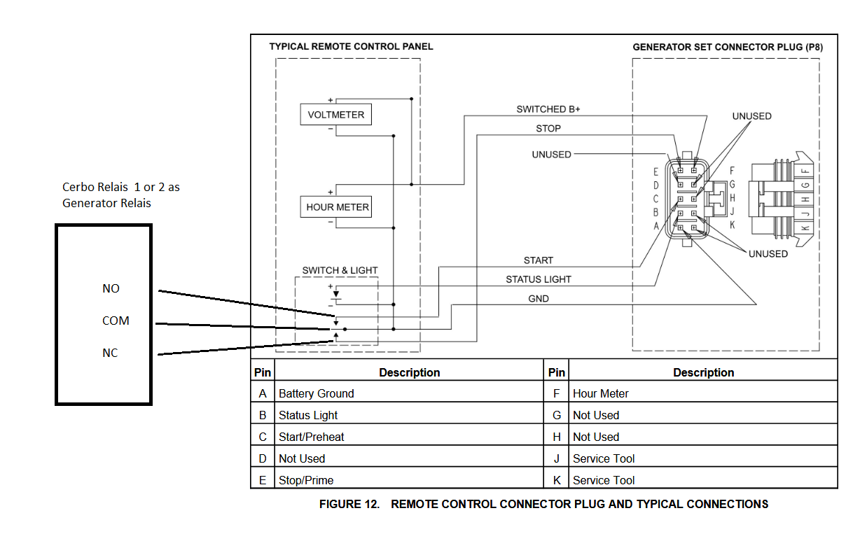

Take a look at the function of relay 1 of the GX … here you can also define a function that monitors the mains supply to ACin 1 … and then switches off the generator.
Thanks again, do I need the 2 or 4 timer relays (as seen in other posts) or are these 3 wires spliced into Start-Stop-Common at existing switch pins?
With such a low load, you can connect the 3 pins directly. The relay can easily handle this “load.”
Use relay 1 from the GX… it can be used directly as a generator relay… including all parameters.

Start and Stop are obvious, which is Common?
Just to confirm, this is Diesel, which i believe has a 3 wire system.
Thanks

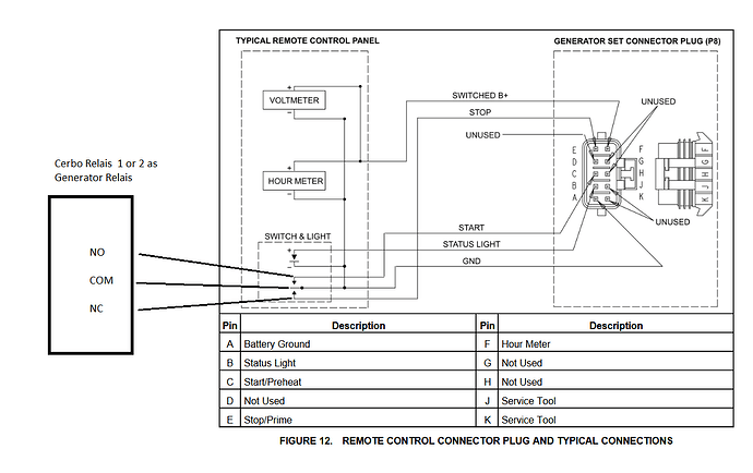

In the drawing, it is switched against ground… so pin 1 (GND) will be the common contact.

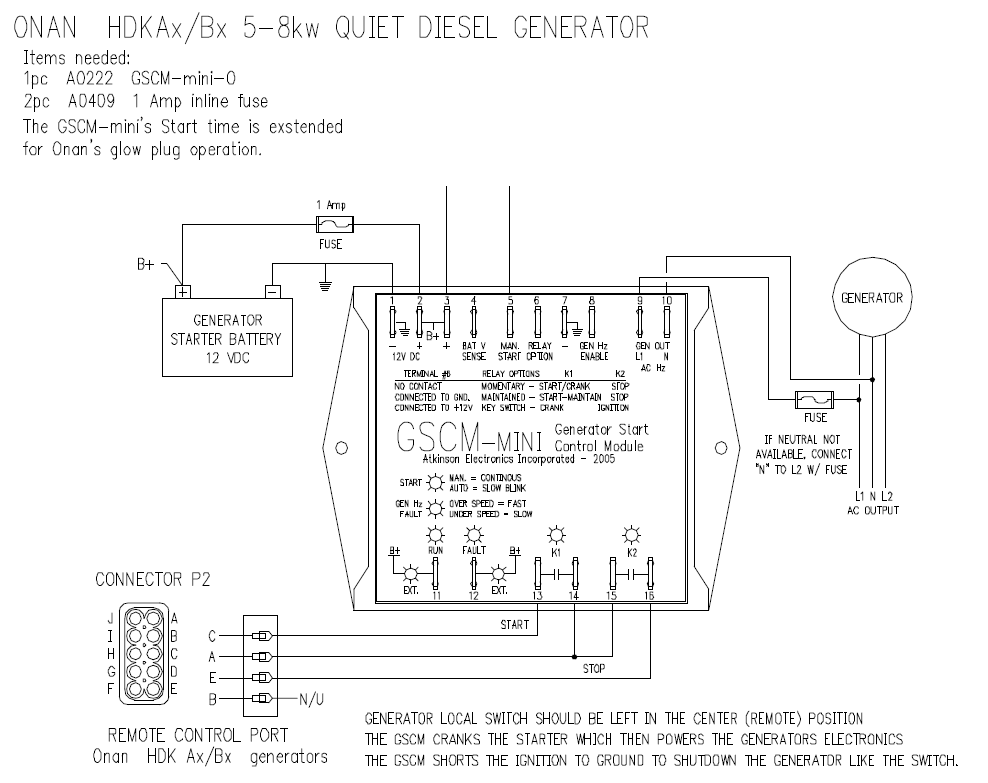

Here is a wiring diagram for their older GSCM line for the QD 8kW Onan:
This would be the GSCM-Mini-D module. The GSCM-Wifi is similar. Send an email to cbdsales@atkinsonel.com and ask them for the wiring diagram for their GSCM-WiFi. Give them your exact Onan model and they will send you a wiring diagram.

It seems there are many models of the GSCM, will the “wifi“ model work for Onan RV QD 8000 using Cerbo GX Mk2?
