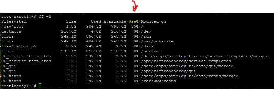

Can you log in with SSH? and run df -h
I will have to give that a try. We use a GX LTE module with the setup, so I will try and see if I can connect my laptop and run the command on SSH. I will update you soon
Hi Fredd, I took my laptop to the Cerbo, enabled SSH and connected to the system. Command runs, the filesystem was at 47% use. I then went ahead and ran the commands to do a factory reset manually over SSH which worked and then tried again without success. I then had a brainwave to take out the GX LTE and try over my Wi-Fi hotspot. This allowed the cerbo to update without issue.. I tried putting the GX LTE into another usb port, but got no response from it anymore. When putting it back into the first port, it worked again but still with updating issues. I feel like I either have some corrupt GX LTE driver or corrosion in one or multiple ports. I will try and get a network connection from the GX LTE to test if this has issues, otherwise I will replace the Cerbo GX.
