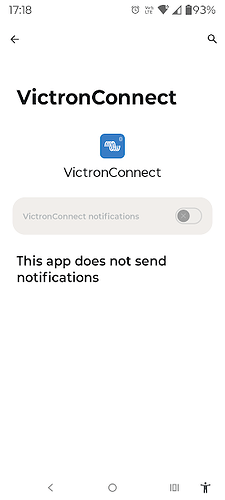

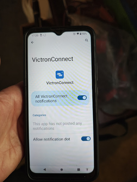

I’ve finally worked out that while android hasn’t blocked notifications for VictronConnect, for some reason the app itself on the Moto Edge won’t let me turn notifications on in the first place. The option to turn them on is greyed out, and it says “This app does not send notifications”. See the difference between the two phones below. The first image is of the phone that won’t connect, the second image is the phone that will connect. I’m assuming this is behind my inability to connect. Any idea on how to resolve this please?
VictronConnect on the Moto Edge. Won’t connect. Notifications greyed out so can’t turn on.
