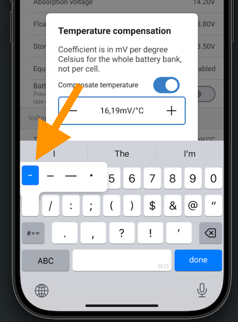

I think I know what could be happening.

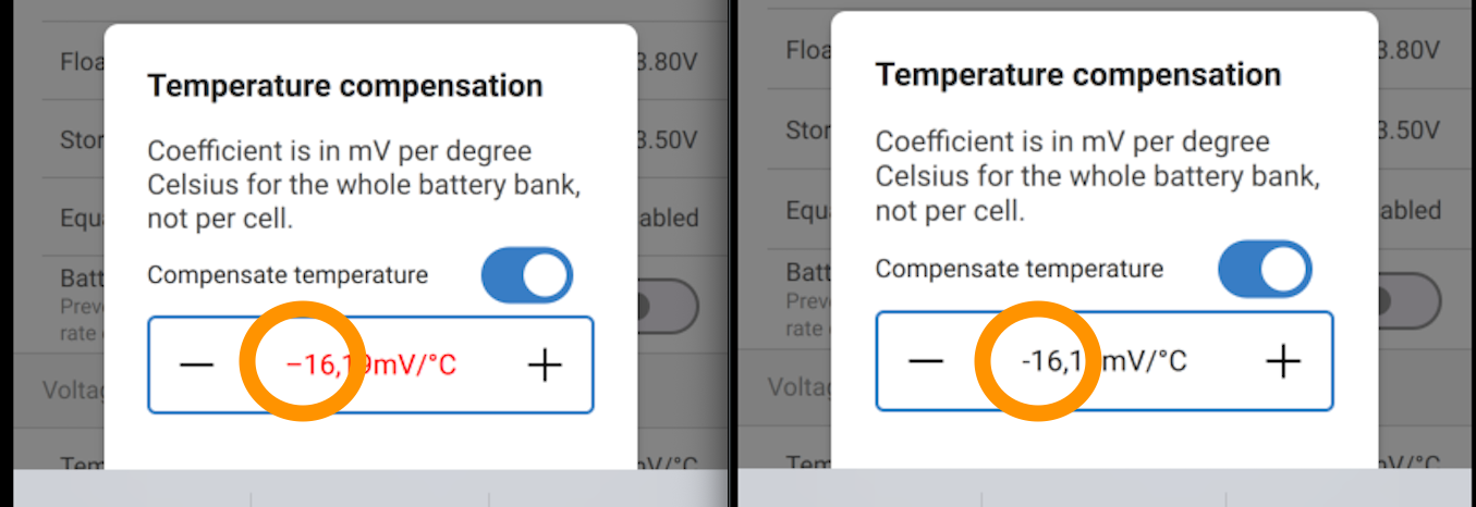

Somehow a wrong negative symbols is being used. Could you please try to remove the minus symbol from the value and type it again but making sure that the “short” one is used? See the screenshots.
Also wold be nice if you can share a screenshot of the value showing in red so we can check what could make the text field to do not accept the input.
I do not have any screenshot unfortunaly, but I asked my customer to test if it worked if he changed the negative symbol and it did indeed solve the issue!
