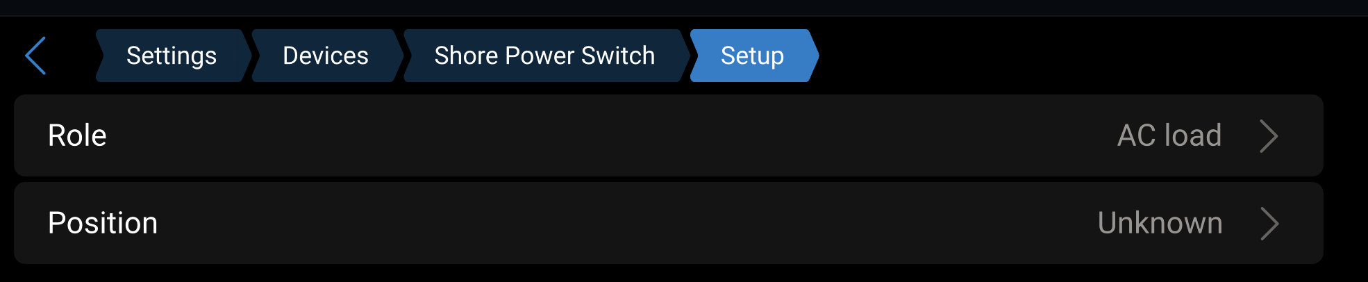

The Plug S however, does not work. It is found by Venus OS, and shows power draw etc on the device page:

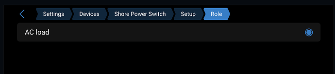

However, under setup I can only select “AC Loads” - I don’t know what that is:
. I can not switch between switch-style and toggle-style switching like I can with the Shelly Plus.
Basically I would like the Shelly Plug to behave much the same way as the Shelly Plus.
I’m pretty certain there’s bugs in here, also since the “Position” selection in the device setup menu doesn’t “stick”.
Looking at the code, it looks like it makes some choices based on the presence of an energy meter or not:
role = 'acload' if c._has_em else 'switch'
which might not be optimal. I’m trying to force it into switch mode now to see how that works.
yup, I ended up disabling the checks for “has energy meter” in code, and now it works as intended (tho of course with all energy metering functionality disabled, which I don’t really need anyway)
