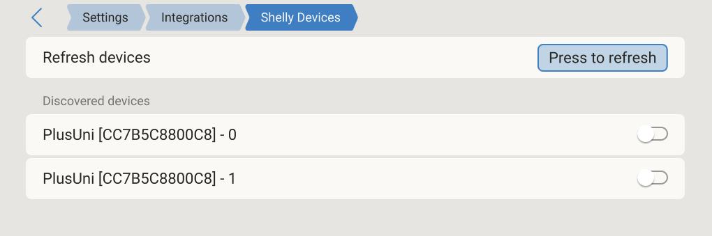

Settings, Integrations, a menu for Shelly devices is there
Can’t recall that before
Do they work ?
What version is that? I don’t have that menu option.
Beta v3.70~19
I’m on v3.70~20 and don’t have that menu, I assume your GX device knows there are some Shelby devices connected (mine are in a box on a shelf so difficult to detect)?
Yes I think you are correct. I have other Shelly devices - a Shelly EM that I use as a grid meter with a 3rd party driver. The EM does not appear
All of my Shelly’s are Ethernet so could be “seen”
Ah, you found it!
It doesn’t fully work yet, few more weeks.

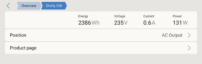

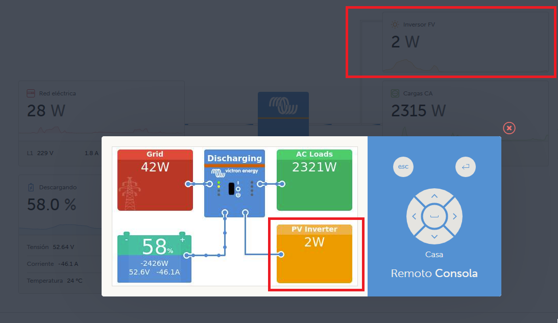

Therefore I modified Fabian Lauer’s dbus-shelly-3em-smartmeter to adapt it to the EM. It is working great but there is a minor glitch in the new Cerbo remote console.

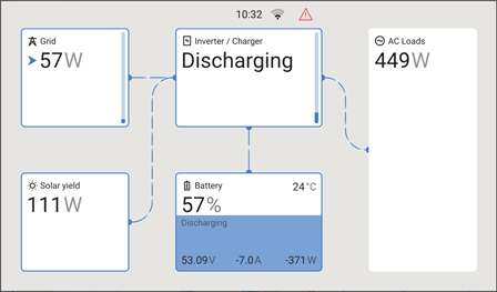

On VRM and the old console, the PV inverter is correctly shown on the output of the multiplus:
While on the new console the pvinverter is shown on the input:
But the information about the device is correctly indicating AC Out:

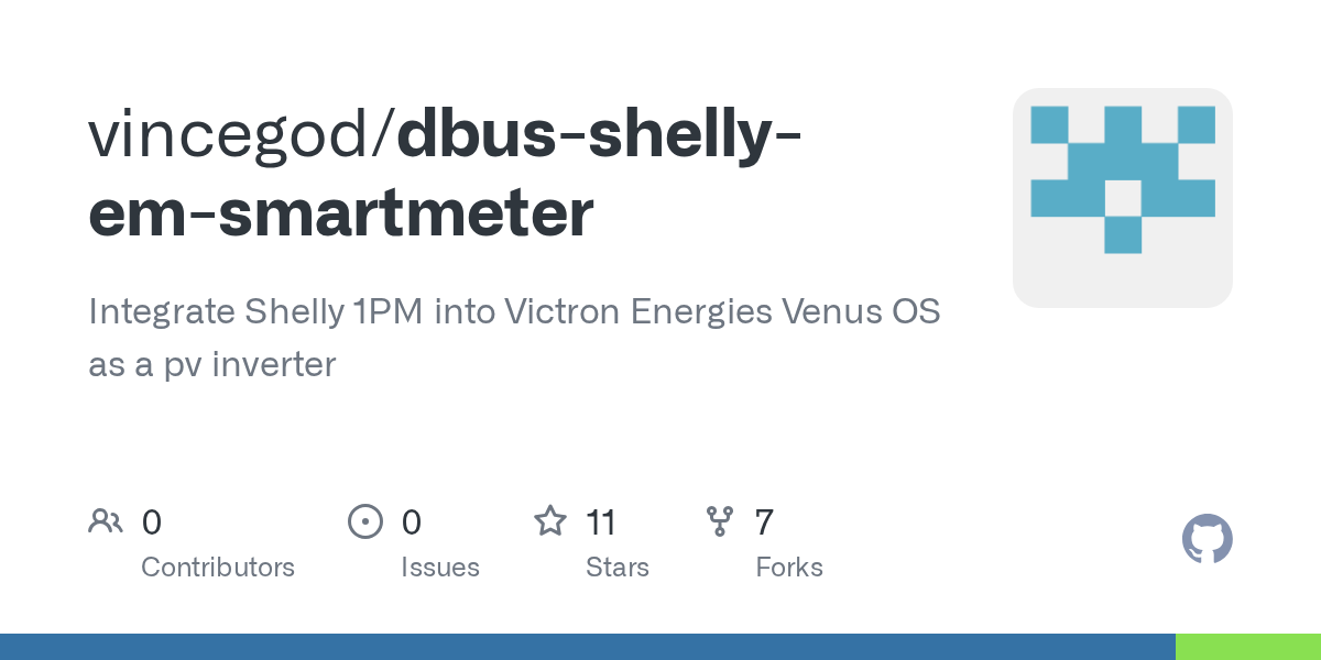

Sorry but my modifications are an ugly hack at the moment, hardcoding the second input from the EM to be pvinverter.
I’ve seen that my modifications are complementary to this project:
Where Vincegod is hardcoding the first input to be a grid meter.
You can use his project if this is the config you have (grid meter, input 1). Otherwise, you can change his code on dbus-shelly-em-smartmeter.py:
I think this should work. If it is not working please drop me a response here and I’ll try to do a proper fork of the repo and publish it (but I cannot promise it’ll be soon).

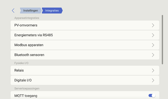

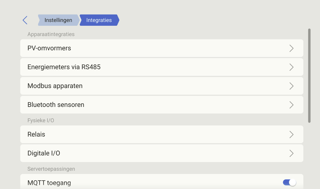

In all 4 of my Victron implementations (Cerbo-S GX/Cerbo GX/Cerbo GX MK2) al on firmware v3.70~46 Large in is GUIv2 ,
There is no menu item Shelly Devices. All location have shelly Gen2 devices, on ethernet-segments .
