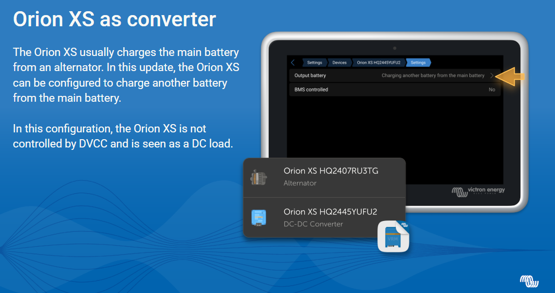

The newly released firmware V3.60 has modifications in it to allow the Orion XS to be treated as a load on the system not a charger. Therefore, you should consider loading V3.60 and performing this check.
What I do not know is if DVCC turns this off if the BMS stops discharging, you may want to connect the ATD from the BMS to the remote pins. However, of course if the contactor opens then this will stop the Orion charging the bow thruster batteries.
If you do not want to upgrade to V3.60 then the simple workaround is to remove the VE direct cable.

If you update, pop the VE Direct back on and update the setting highlighted and see how it goes. The people who tested this during beta phase said that it successfully resolved this issue.
