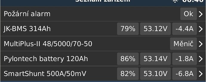

Please advise. I have 2x two sets of batteries with BMS connected to the cerbo via BMS.Can and VE.Can. In the cerbo, the battery descriptions are displayed correctly. In the VRM, two batteries are displayed, but with the same description (name). In the device, there is only one battery with a description (name), which I connect last.

yeah,i now understand(need to properly read the pictures),you have pylon and jk…i have similar-pylon cells and jk bms :slight_smile: what about battery agregator,have you tried? it needs to be installed from kwindrem’s setuphelper (and that is installed from usb and simple reboot),you get to it from gui-v1 only i think, it adds another bms,but it should contain all batteries…not what you want probably,but could help? the problem is jk acting as pylontech(you select it in jk protocol settings),so if you want to tinker,try another protocol? and maybe firmware update,if you have inverter bms,andy on youtube offgrid garage has some useful info(you probably know this)

I have the same problem:
1 Pylontech at BMS-Can, 1 JK-BMS at VE.Can.
Both are detected and shown correctly in the Cerbo Device List (with correct values).
But they have the same VRM-Instance ID (both 512).
So in VRM, there is only one of them shown. It switches between the two, sometimes showing the values of the Pylontech and sometimes those of the JK.
Node Red has the same problem.
I assue this is related to both having the same VRM-Instance ID, but I’m not sure.
And I could not find out how to fix this.

I connected the JK via RS485 (with SerialBattery Software) now while the Pylontech remains on CAN.
Works perfectly. JK now got VRMInstance 1. I can select it as “controling” battery. I can read it’s data in NodeRed and it is shown in VRM Overview below the primary (Pylontech) battery.
I think it’s a bug that both CAN batteries got the Instance 512, and this then causes all the other problems.
