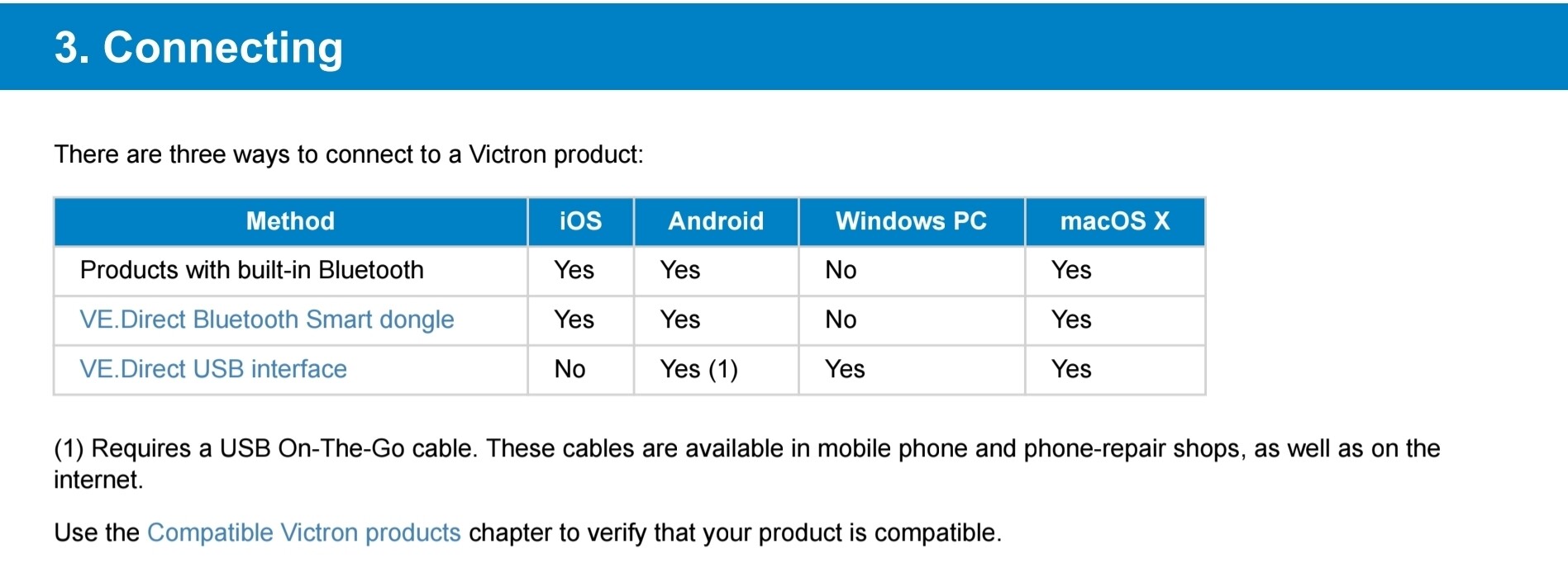

Attempting to connect to IP22 through Victron Connect on my pc
I have Victron Connect (Windows) downloaded on my laptop, which has Bluetooth capability. I connected the IP22 charger to mains power, and enabled bluetooth on my laptop (it allowed me to pair up), but when I opened up Connect, it did not recognize any bluetooth devices. I was literally a foot away from the charger. Will Connect only work through a cell phone/tablet? There is no port on the IP22 for an ethernet or other wire.
Thanks in advance for any help.
Correct there’s no Bluetooth capability from Victron Connect for Windows.
