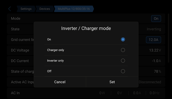

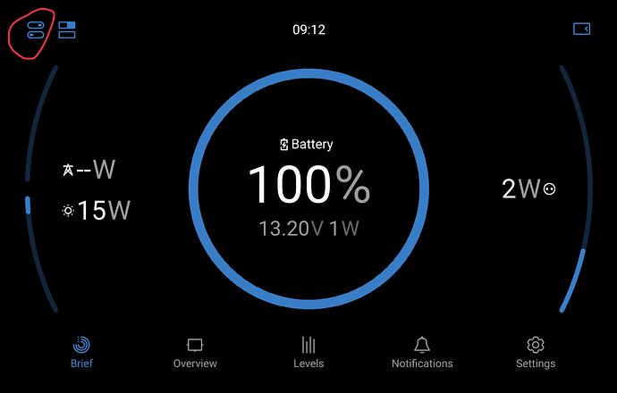

@Guentha You are correct in the switch is on, charger only or off. There are a number of ways to manage it.
From the console in the device list or even easier the red selection. If you do not require the AC charger, you can disable it in the inverter settings. Victronconnect, a smarphone or device and MK3 is also a cheaper option, but once you used an GX device, you will wonder how you lived without it :wink:
