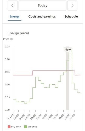

Why is that, I do not understand how this is profitable in any way? DESS just managed to lose one of the two profitable selling opportunities, and is well on its way to losing the other as well.

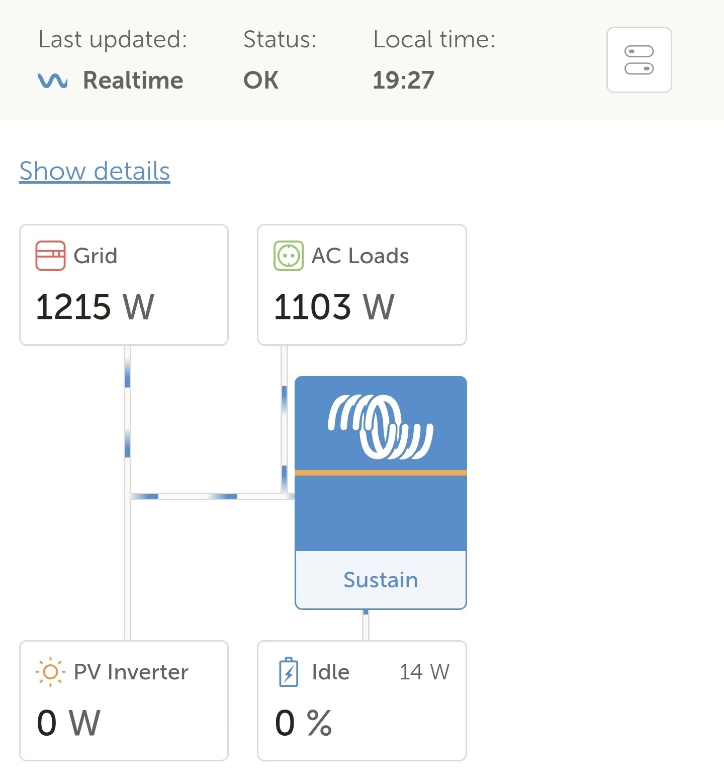

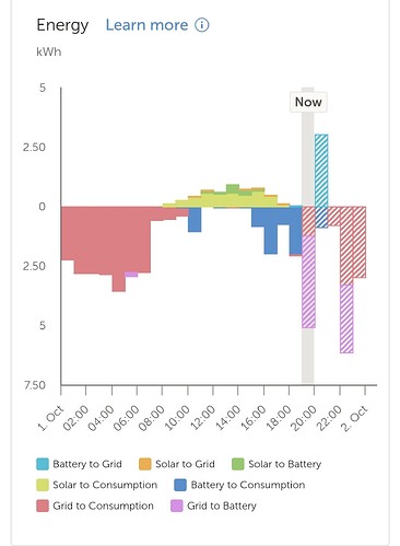

Half an hour left of the hour, and DESS ran the SOC to zero. It’s broken for sure. It used to work reasonably well, but maybe the 15 minute changes added some regressions.
The two expensive hours are basically over now. DESS failed to sell anything.

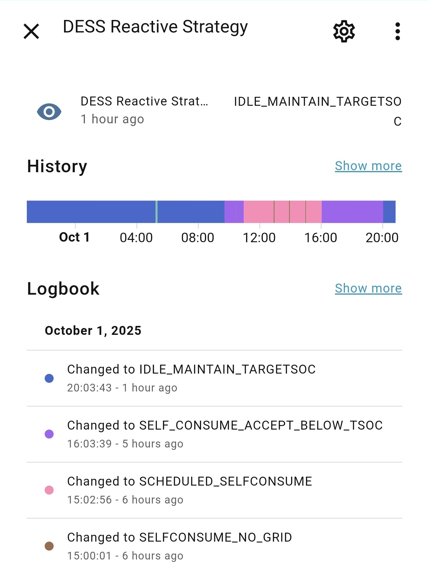

@dognose curious if you have thoughts here? My system unexpectedly self consumed down to min SOC as well the other day, under the new reactive strategy (the VRM plan was to consume from grid).

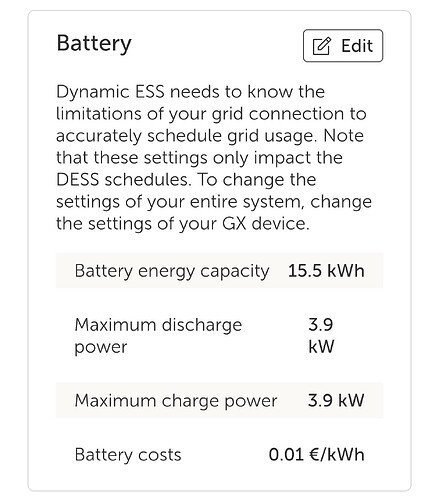

Even for a DIY battery, 0.01€/kWh is not realistic.
If you feed the system nonsensical input, don’t complain if it produces nonsensical output.

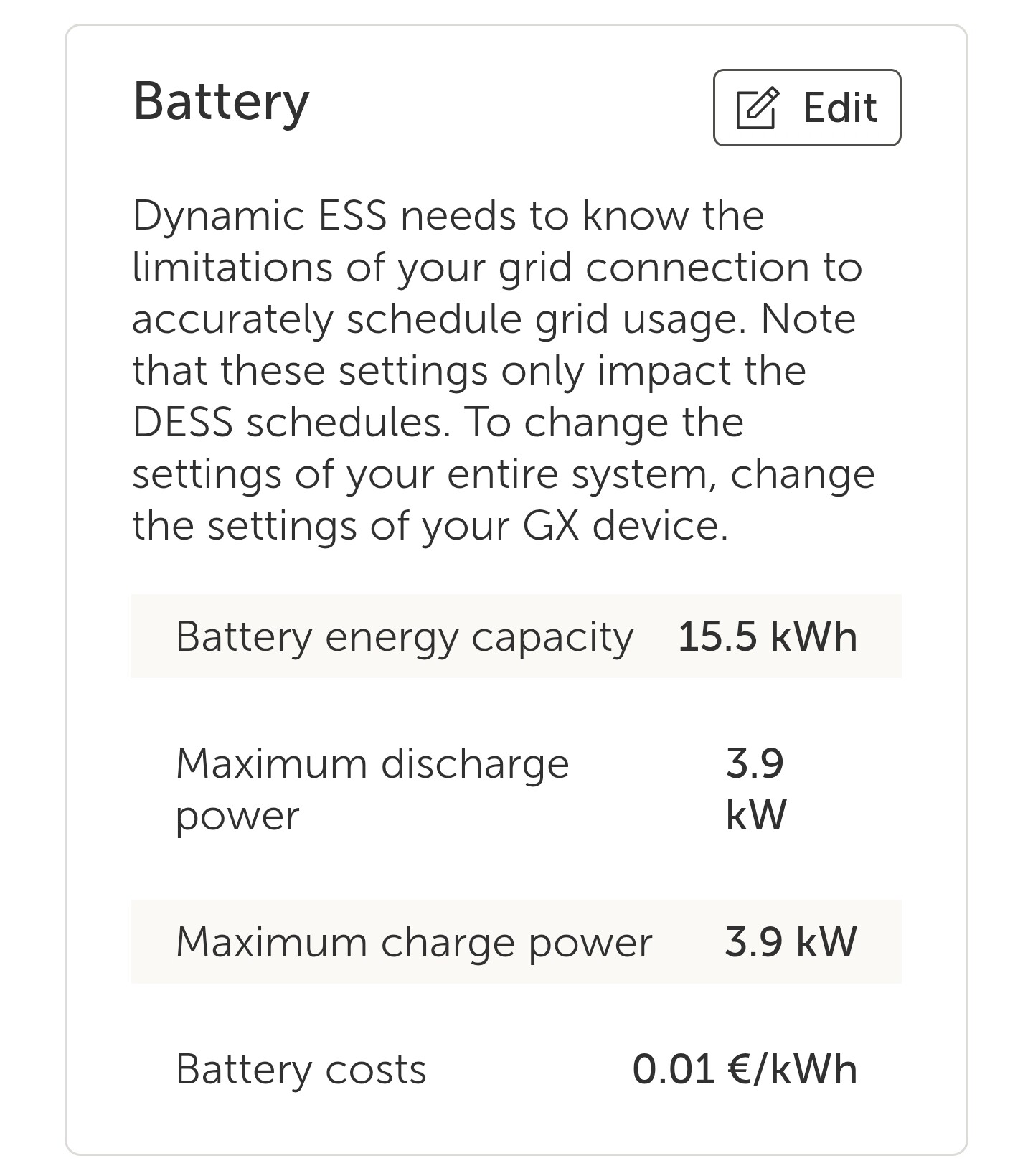

1000€ for the cells, ~16kWh and 8000 cycles of life as per the datasheet. Do the math if you wish.
Please also explain how low battery cost has anything to do with this sort of logic failure.

Furthermore, if the battery cost was zero, the system should actually be more eager to take small wins from buying & selling. And that is not even what happened here. DESS actually correctly planned the trade, but failed to execute its own plan.

I’m presuming you’re on the 3.7 beta? That’s where the reactive strategy you’re mentioning is from (self consume below tsoc), but best to confirm.
Yeah, currently 3.70~34. Looks like ~40 is out, I suppose I might as well upgrade to that one.
You might consider commenting on the latest beta thread, highlighting your issue with the new reactive strategy.

It’s actually quite simple. No matter how realistic the battery costs are, the higher they are, the less the DESS will react to such mini-cycles. If I were you, I’d experiment a bit here. My realistic costs are somewhere in the range of 1-3 cents. At 1 cent, the system was too reactive for me; at 3 cents, it only used the storage when there were extreme price differences. I’m now at 2 cents. Something else to plan and implement. Of course, the DESS has a long-term plan. However, it’s constantly being revised. If circumstances change, such as the consumption forecast, or if the solar yield deviates from the calculated one, this will change the plan. A huge advantage of the current DESS. Next point… your battery seems small compared to your consumption, so small changes in the forecasts have serious consequences. Finally, the last point: what are your charging and discharging rates based on? The 3.9 kW? They absolutely have to correspond to realistic values ​​and not some theoretical maximum output listed in a manual. If there’s a bottleneck somewhere that prevents the system from achieving this performance, the schedule won’t work and will be constantly revised. The system calculates that it will discharge or charge 3.9 kW within hour X. If this isn’t implemented, the plan will fail again and again. I hope I’ve explained how important the configurations are and how fundamental it is to engage with them.

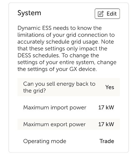

Well, thanks for taking the time to reply. You are obviously correct saying that higher battery costs cause DESS to react less to such opportunities. That is part of the reason why (considering my low battery cost) I disagree with the ā€œself consumption below TSOCā€ decision DESS made. DESS should have prevented self consumption, idled for a few hours, then sold when it was expensive.
3.9kW is correct for the current limit and fuses my MPII 48/5000 is behind. My system consistently achieves this. Typically DESS works absolutely flawlessly and the battery SOCs it plans are typically spot on, highlighting correct system settings. Yesterday was simply an unexpected quirk, so I reported it.
To be honest, it feels like we are now trying to find what mistake I made instead of focusing on the logic issue. By the way, I charge my car during the night, and I expect DESS to charge then as well if needed or if it provides a future selling opportunity, of course depending on solar and day ahead prices. DESS has rarely tried to cover my nighttime consumption, which is absolutely the correct decision. I doubt green mode would be correct for my use case, since I specifically want the system to trade. My purchase contract is moving to dynamic pricing in 4 wks, which probably adds more trade opportunities.
I didn’t mean to blame you or defend DESS or Victron. I’ve been involved with this topic for about two years now and have read about a few problems here and experienced some myself. Therefore, I wanted to point out some of the most basic issues. Nothing more, nothing less. Check whether the actual charging and discharging power really corresponds to the 3.9 kW. I spent some time trying to find realistic values ​​in this area.
