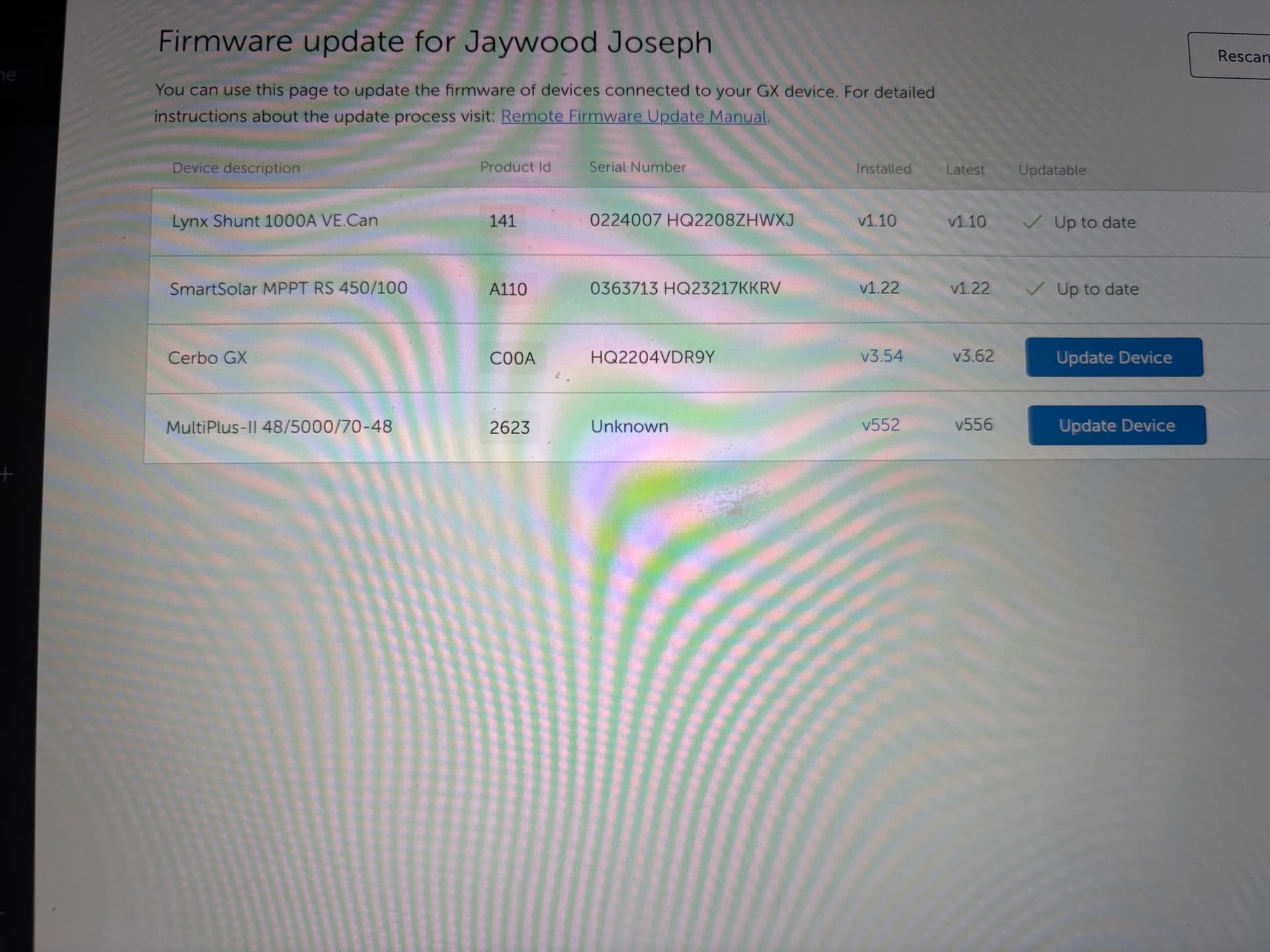

By that chance, just upgrading from your 3.54 to 3.62 will also bring you a variety of general DESS improvements. 3.70~6 then adds another tiny improvement as mentioned above.

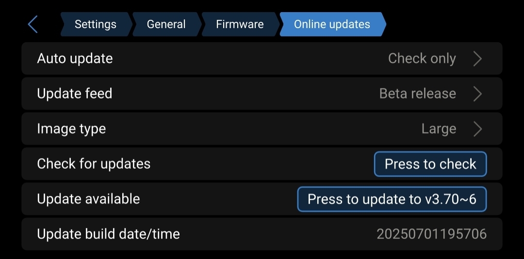

Thanks for the help, I upgraded to 3.62 but can not see 3.70~6 as an available upload. I’m showing no uploads available.
For that, you would need to set the Update Feed to Beta, and then checl for updates again.
dognose - A big thank you for your help on the firmware update. It’s a joy to watch it behaving its self now. I’m currently away from home so the load is very low. When we get home I can report back on how it handles daily power use.
