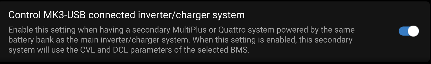

Other possibility is a second MP with own MK3 Interface
Search at the Cerbo manual for MK3 for more details
The idea would be to define relay 1 as a generator and switch the second MP over it and control it using the periodic operation function for daily run
Hi, thank you. It is probably what I’ll go for as it least it aggragates the information in the cumulative totals.
Thanks. I haven’t seen that option. Presumably it appears when I have a unit connected with the mk3 .

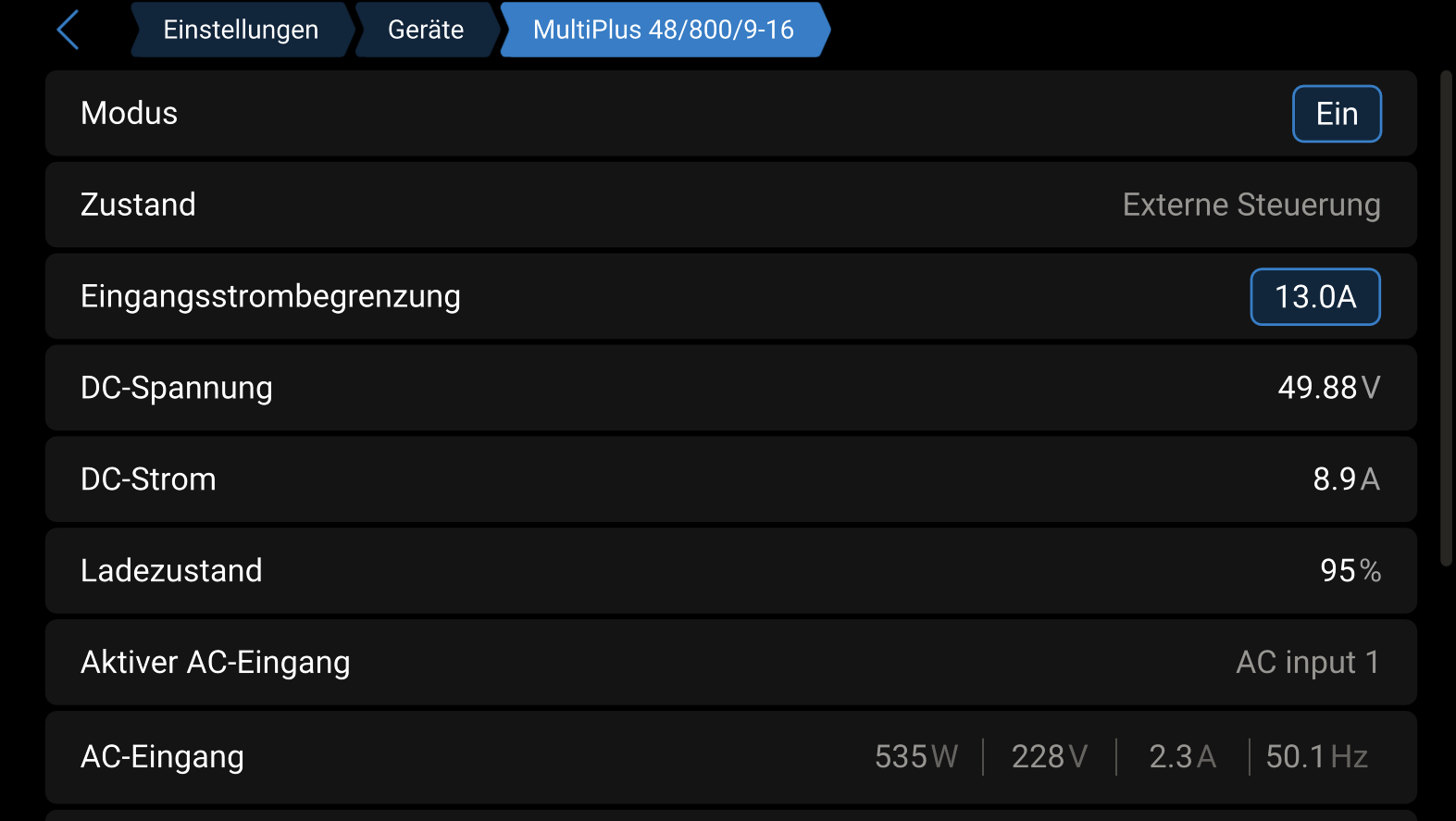

Would I have some visibility on the data of that inverter on the VRM or cerbo?
There is no additional view for the second charger than this above.
Perhaps you could use the cerbo relay 1 as “generator” to steer the MP2 3k over this remote control port.
How did you connect the second inverter?
I understand that the control can’t be done with the VRM but can we at least check the data for the second inverter?
I would like to have AC IN voltage and frequency for example.
I have Pylontech batteries. I simply programmed the second , “charger” MP according to the specifications for Pylontech. But without grid code and ESS assistant.
The remote console in VRM gives me the same settings and display values as for the first MP.
The second one is connected via usb right?
Yes , with Mk3 USB Interface
