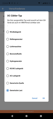

Have a ock at the Demo products at Victron Connect.
Search for smart shunt and as what it can be programmed…
