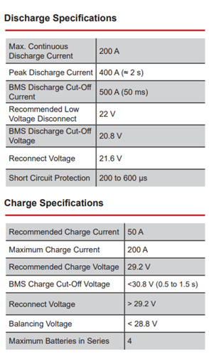

I checked the datasheet
Data-sheet-en-A200-24.pdf (400,4 KB)

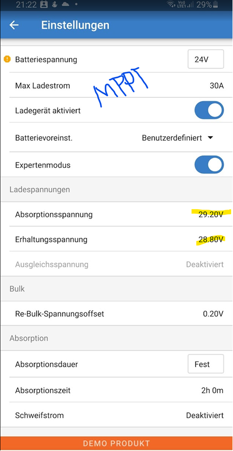

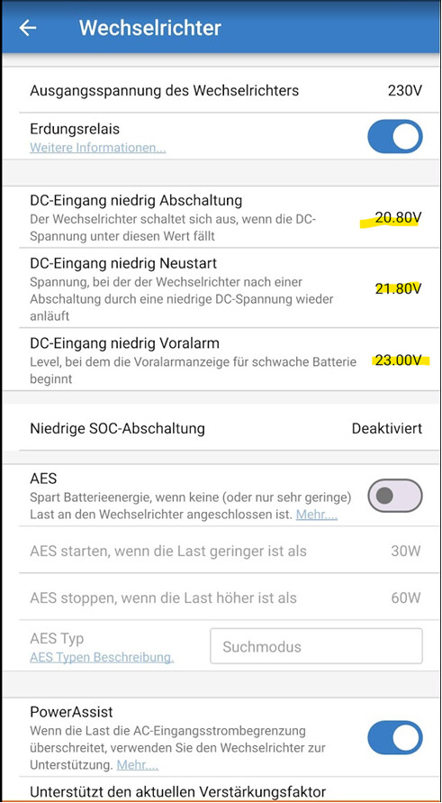

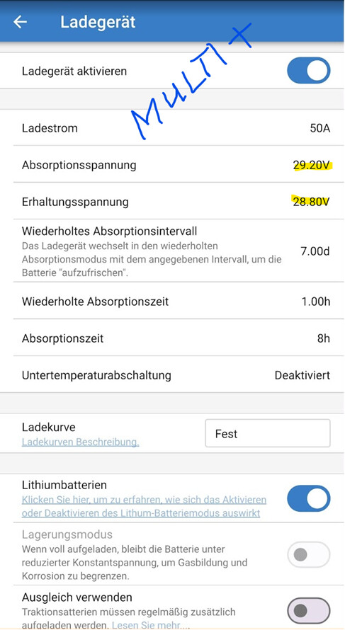

Victron LiFePo default settings
Absorbtionvoltage 28.8V → some other Batteries like LiTime write in the Datasheet 28.8V +/-0.4V
Floating voltage 27.6V
Below how i interpreted the datasheet.
Would this be ok?
Has somebody here experience with acconic or how adjust the voltages proper?
Thanks in advance for answers
Given the manufactures datasheet is not complete, and the resellers answers to your query are less than helpful, this would not be a battery worthy of consideration.
Look for other more forthcoming manufacturers and resellers that can give proper battery specs and advice.
