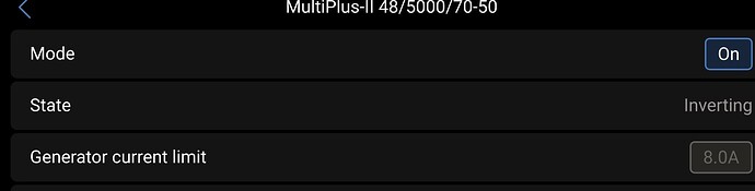

Do these images help describe my problem?. Overruled by remote is disabled as this is a ‘static’ system, bolted onto my shed’s wall and it’s recommended for my solution… :slight_smile:
