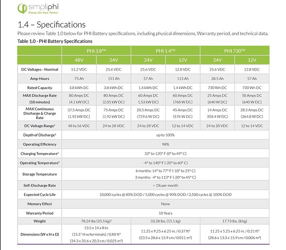

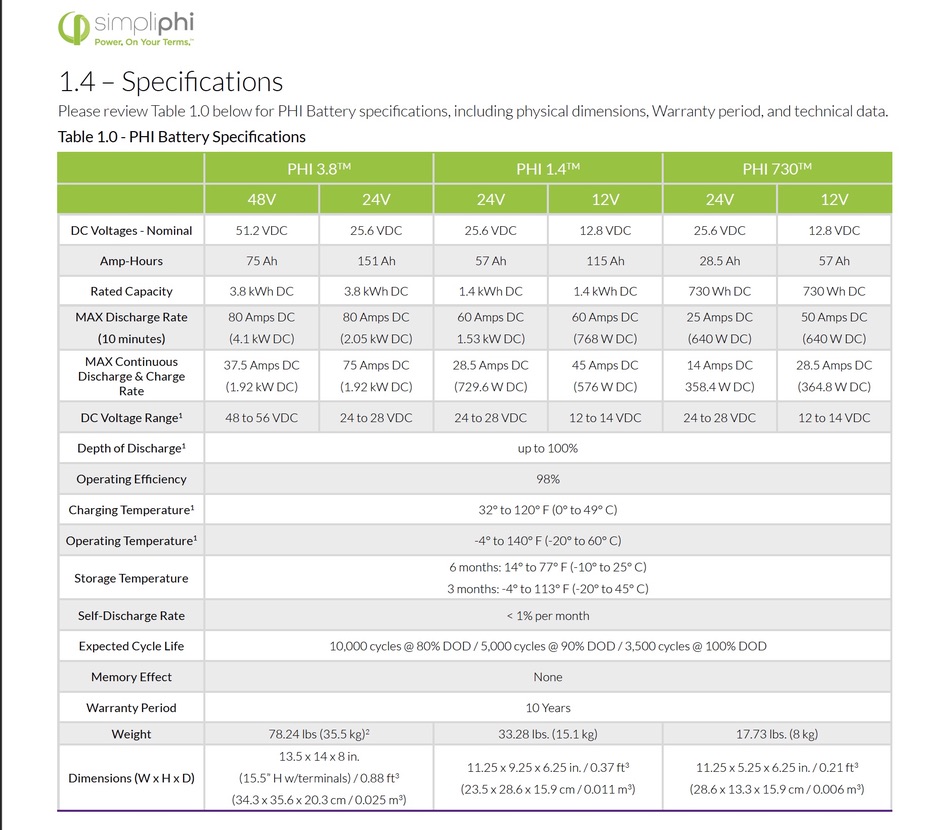

I have a 4 battery bank using Simplfi PHI1.4 12 volt

As you have lithium batteries, if they are at 13.9V and only taking 4A then they are more than 99% full so they will not take much charge.
The other thing is to use a multimeter to check the Multiplus terminal voltage and the battery terminal voltage, these should be the same with only 4A, If they are different check all connections, fuses and breakers etc for voltage drop.
