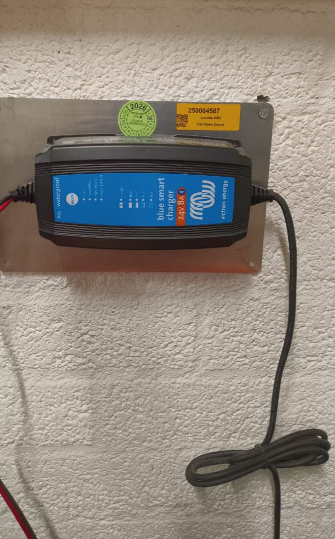

Wiring sleeve cracking issue in 220 Volt supply of an 8 Amp charger
Hi, we bought 200 chargers of victron. After 4 months we get customer feedbacks. Are there people recgonizing this issue? Wiring crack of the sleeves. We have already more thank 20 cases after a short inventarisation.
Coiling the cable and tying it like that won’t have helped. I would have made the cable the right length. If you can’t shorten the cable then coiling it with no tight corners would be preferable.
Hi. I understand. But 200 Watt charger? No heat at all. And not one, all of them in different ways. This cable should stand for 50 years and yes it could be better mounted. But i think it is a manufactures issue.
As the damage is only local at one point, its no UV problem of the insulation. Possibly mechanical damage or rats/animals problem?
Hi. Thanx for your reaction. We have over 15 chargers located with this issue. Overall the sleeve is thin and damage is random. We also thought about rats. But not the case. It’s a hospital in the Netherlands. We investigate possibilities of chemicals for cleaning. If that is not the case we consider a manufacture’s issue
