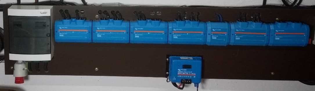

I myself use a Pylontech battery bank with 20 US2000C units and rely completely on the Pylontech internal BMS and the SOC display derived from it. I have no problems whatsoever with it. My system has been running for over five years now.
When designing my system in 2020, I opted for a homemade busbar, not least for space reasons. In fact, I even used Victron fuse holders with 48V megafuses. It was only after completion that I had doubts and concerns about whether the Victron Megafuses were even capable of safely tripping and shutting down the high currents that occur in the event of a short circuit in a lithium battery bank. During my subsequent research on this topic, I noticed that Victron does not provide any specifications regarding the tripping capacity of the Victron Megafuses.
If you are concerned about the breaking capacity of the fuses used, you will always end up with NH00 fuses. Only there will you find manufacturers who offer fuses with a breaking capacity significantly greater than 20 kA DC, in some cases even more than 100 kA DC, according to the data sheet. And on top of that, you also get fuses that use a micro switch in the NH00 fuse base to indicate whether the fuse has tripped or is still intact. This gives you, with minimal effort, a potential-free visualization (LED) similar to that provided internally by the Lynx system and the function of (remote) fuse monitoring via micro switches. Even if this does not automatically provide visualization in the VRM console.
Victron does not provide any information on the switching capacity of Victron Megafuses, so I assume values well below 1 kA DC. This value seems acceptable for lead-acid batteries, but not for lithium batteries.
It appears that new ceramic megafuses from Victron, compatible with the Lynx system, are already available or will be available shortly. Due to their ceramic housing, these new fuses appear to be more robust than the megafuses with plastic housing that are still available. However, there are no specifications regarding their breaking capacity. I have therefore decided to convert my busbar with Victron megafuses to NH0 fuse holders and fuses.
