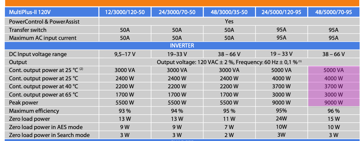

The Multiplus-II 48/5000-70 120V has peak surge power of 9000 W.
Therefore, I believe it will handle the surge when the pump starts, though it probably will dim the lights badly. And you have no room for other loads simultaneously, which is a great inconvenience. Make sure you have sufficient battery capacity and thick enough cables because that is a huge hunk of power.
Here is some info on overloading and peak power.
The takeaway here is that the inverter will do 150% of rating for 5 seconds, which is 6000W.
