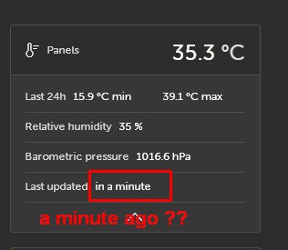

In VRM, in places where it says: “Last updated”, you can find texts like “in a few seconds” or “in a minute”.
But those forms (“in a …”) are referring to a future tense, not a past tense, like “Last updated”.
Isn’t it more correct like “a few seconds ago” or “a minute ago”, by using “… ago” ?
Thanks!

I am talking about release VRM, not beta.
Sorry not mentioning that, but I don’t know where to post problems about release VRM.
Also, the same bad wording for French, Italian, etc.

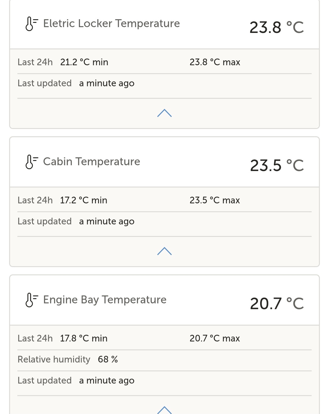

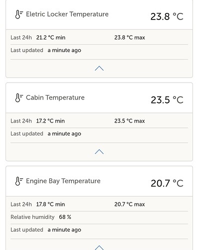

Very observant @alexpescaru .
Evening looks correct on my devices. Places I have looked:
  1. VRM app on Android phone
  2. Chrome browser on Android
  3. iPhone app on SE
  4. Safari on iPhone
  5. iPhone widget
  6. Win 10 tablet via FF
  7. Win 11 laptop via FF and Chrome
    F.

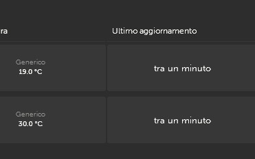

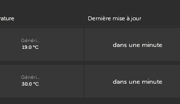

Here below for other languages, after I’ve changed them through VRM → Preferences → Language
Italian, where it should be “un minuto fa”, not “tra un minuto”
Or in French, where it should be “il y a une minute”, not “dans une minute”
Or Spanish, where it should be “hace un minuto”, not “en un minuto”
All of them are in the future, not in the past…

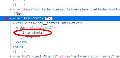

You seem that you are using Petr Bela’s “moment” library for manipulating dates, or forked code based on this.
In one of the files in:
node_modules/moment-timezone/node_modules/moment/locale/xx.js
somehow the parameter (isFuture) is badly sent.
Therefore the problem with the future formulation.
Kindly please, take a look at those files.
The text we are talking about is not stored in a “locale” database, but dynamically built inside the functions, based on parameters passed.
