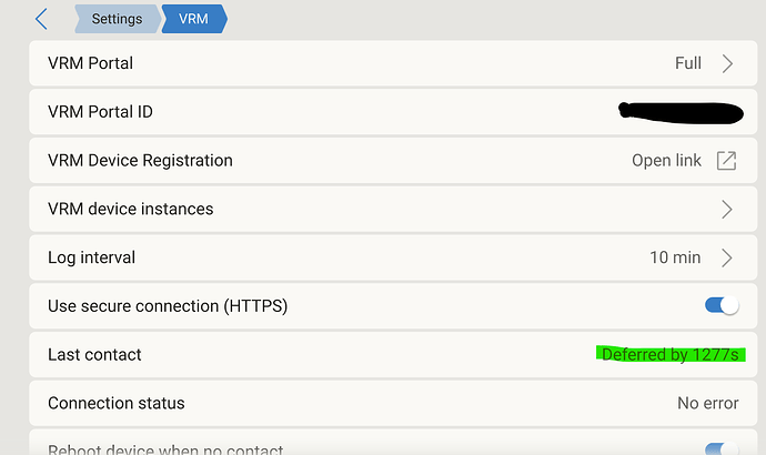

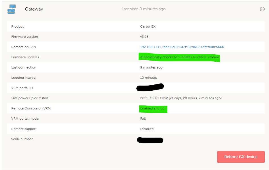

We are getting unusual interaction between the Cerbo device and the VRM server:
After updating from 3.64 to 3.66, I get this on the VRM device List:
and on the remote dashboard, it is showing this:
For reference, a working system looks like this:
Looking for any advice from those working on the back end - as there seems to be a common issue here.
