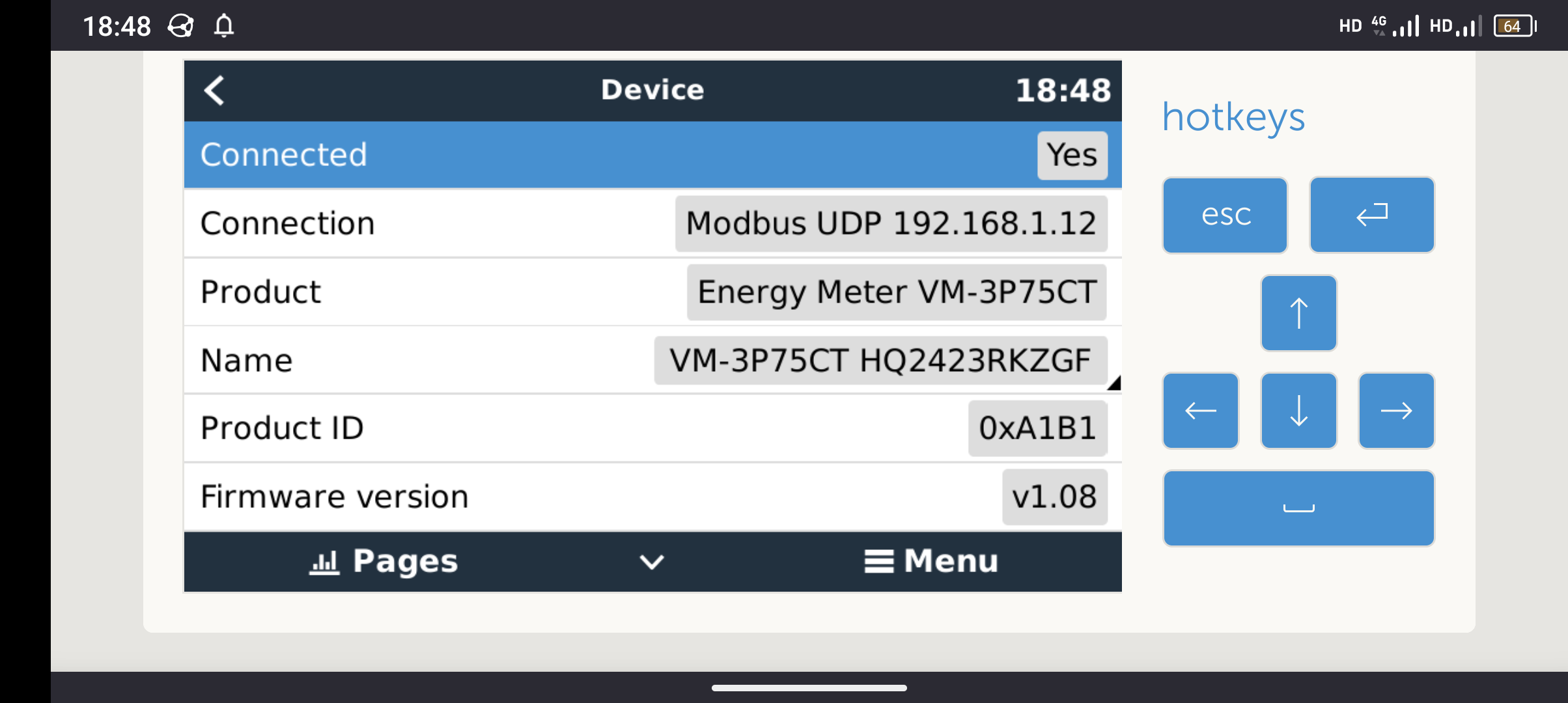

my VM-3P75CT [VM3] is connected to my cerbo gx via Powerline/LAN/WLAN/LAN since many months.
Yes, it’s a little crazy but mostly functional. Sometimes the connection goes down. In the evening occurs disturbances on the (power)line from the grid outside.

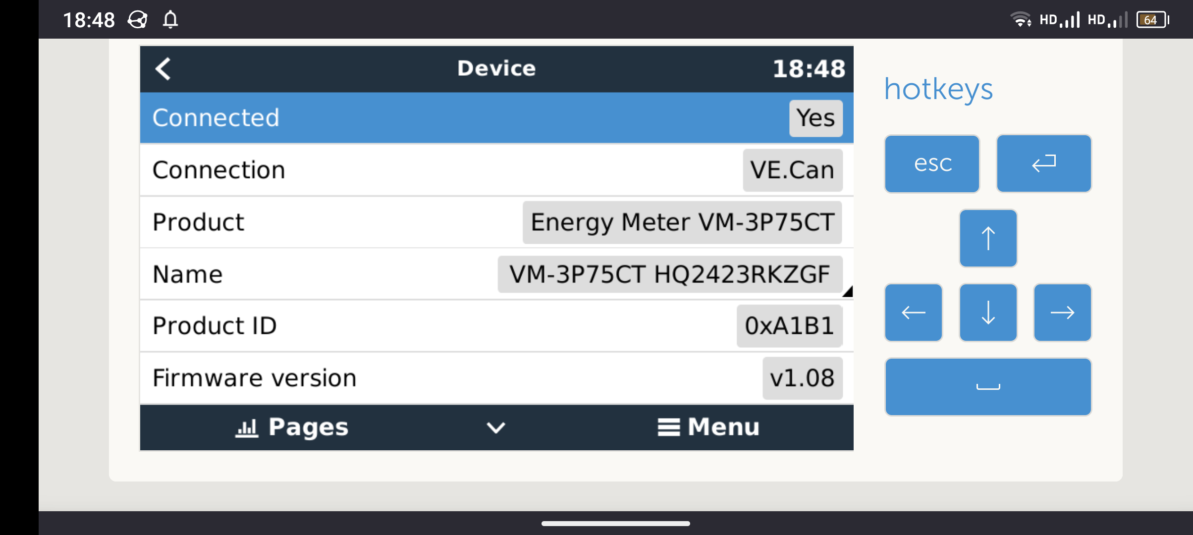

So, yesterday I connected my VM3 over a 25 m VE.Can Bus line to my cerbo gx.
I connected the VE.Can Bus line, and disconnect the LAN connection from the VM3.
The VE.Can device was immediately listed in the cerbo and functional.

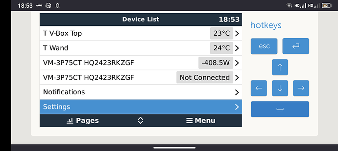

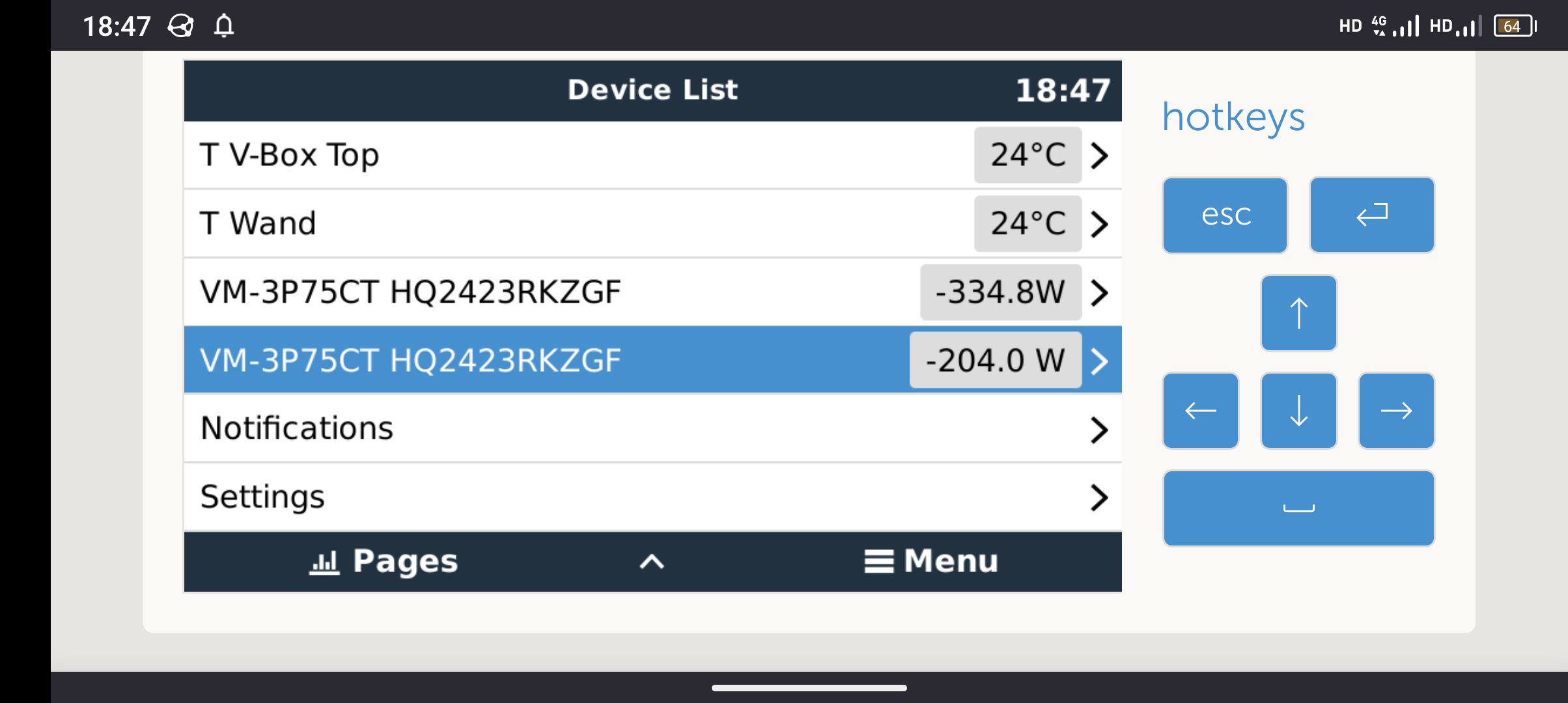

But… now in the cerbo are TWO VM3s with identical S/N and similary power values listed. (If I rename the first entry, insert “VE.Can” to the string, BOTH entries will be renamed…)
- Is this a problem, two VM3 instances?
The ESS is running fine.

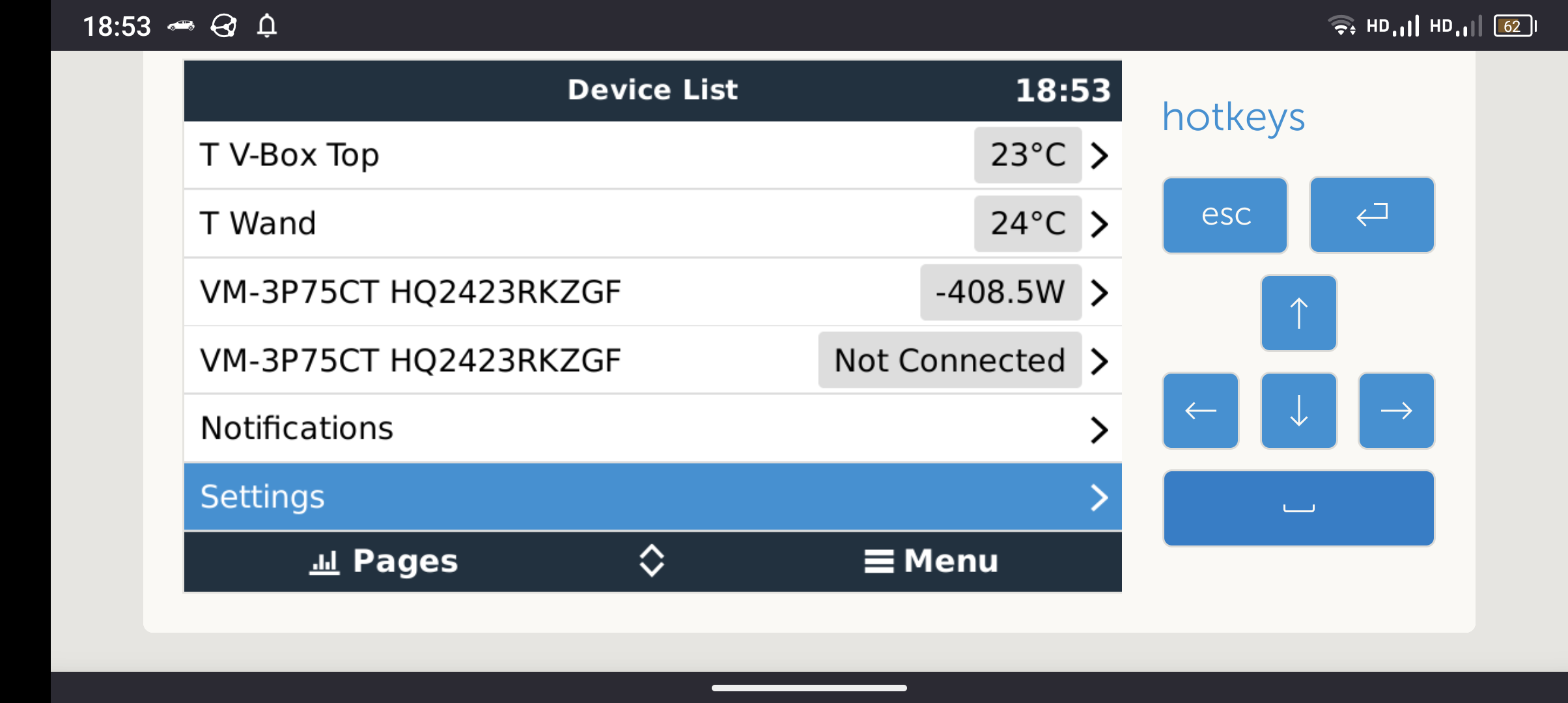

For safety reasons I disabled the Modbus VM3 device. (last screenshot)

VE.Can entry has VRM instance 0
LAN entry has VRM instance 40
