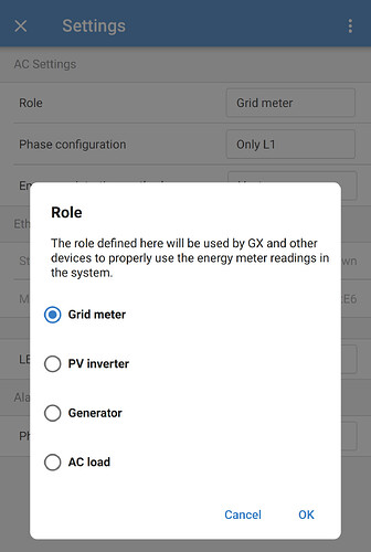

I am looking into buying an extra set of meters to visualize AC Loads in my home and also to visualize my EV charger. Could you do me a favor please?
What happens if you mark/tag the meter as “AC load”? Does it show up as a “child” of AC Loads in VRM? Can you rename it so it shows as a separate tile?
Greatly appreciated if you could test this for me, many thanks in advance.
For your information, I have an EM24 meter and running Victron OS v3.55 on the Cerbo and I have the ability to set the EM24 as “EV charger”:
It does nothing does not show up in the VRM do gram but shows as a device in VRM and the role can only be done through Connect not sure why Victron pulled it from there own meter VM-3P75CT but it’s made this meter very basic, like not being able to use the other clamps on a single phase install for other things to monitor through the one device ie like solar heat pump and EV with just the one device would have been nice not sure if this has been abandoned or is in the works but to do that the clamps themselves would have to come up as the devices that could be assigned roles not sure if @guystewart could shed any light here?

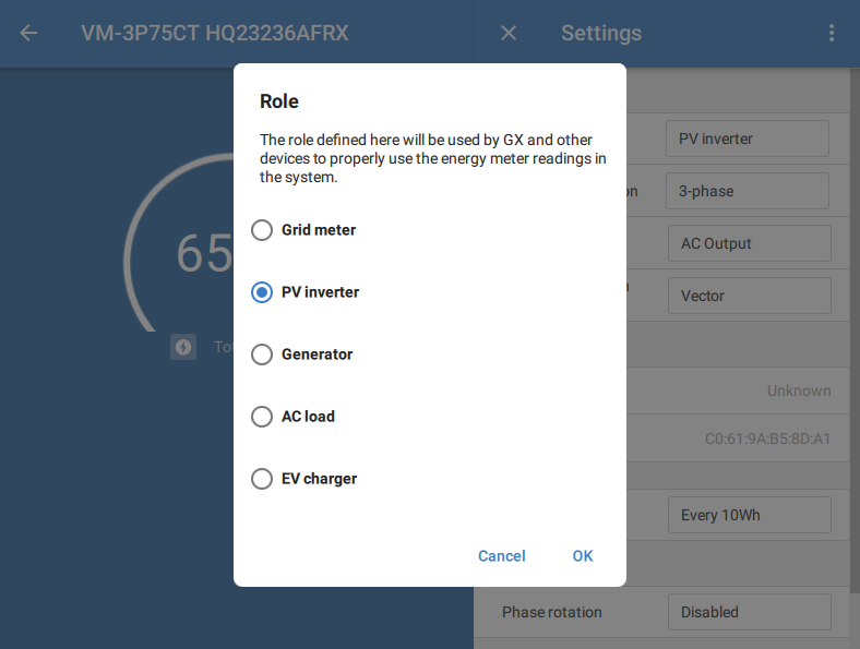

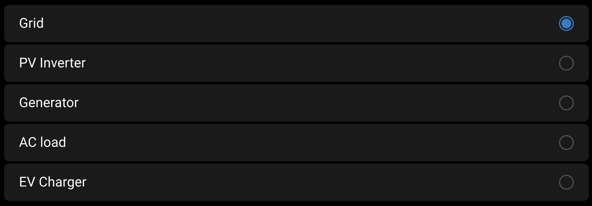

The VM-3P75CT firmware already supports the EV charger role, but the release version of VictronConnect has not implemented this yet. When using the latest VictronConnect beta (6.20-beta15 at the moment), you should be able to set the role to EV charger.
@Luc this looks absolutely awesome! My extra meter should arrive in a few days so I’ll test this out.

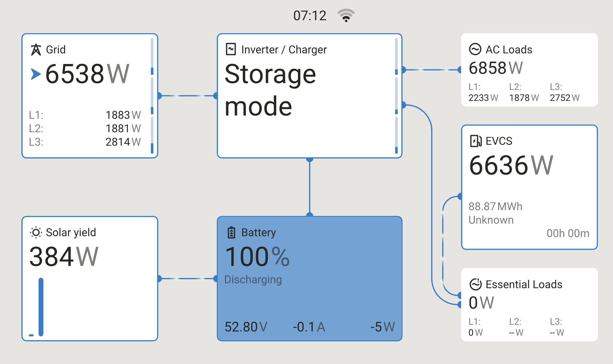

I now see the EV Charger option in the Beta app :raising_hands:
I’m very thankful for all the work you do!

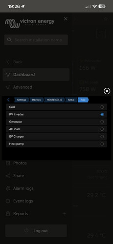

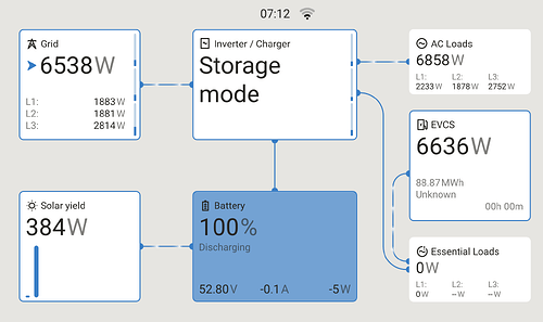

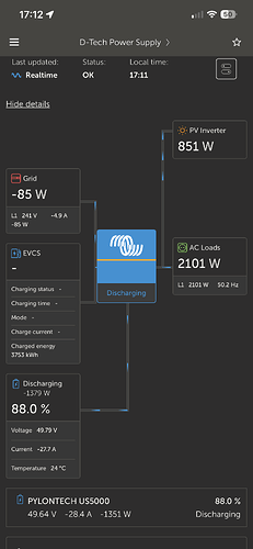

@Luc Ah great thanks never knew there was a beta for connect it seems like it’s on steroids it’s so snappy, I’ve updated but it does not seem to show watts in the VRM but does display on the remote console but the remote console is showing the charger in the wrong place but the VRM is showing it in the right place I take it that this is a limitation of the New UI on how much can go input side? Also is there any chance that is single phase installs would be able to use the other CT’s to monitor other devices?
Hi @Daza, VRM might not yet support this, but I don’t know for sure.

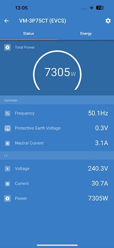

My second VM-3P75CT arrived today. Changed role in Victron Connect (v6.20beta16) to EV Charger - though when I go back to that configuration dialogue the role shows as blank sometimes….
It seems you set it, then it polls the role and then can’t display it so shows blank? Could be a small Beta glitch?

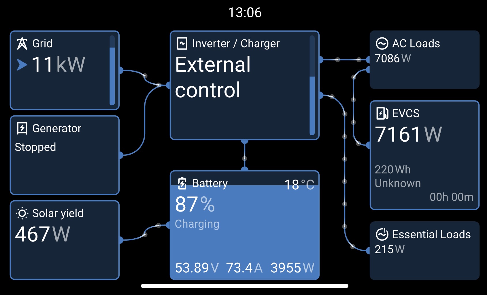

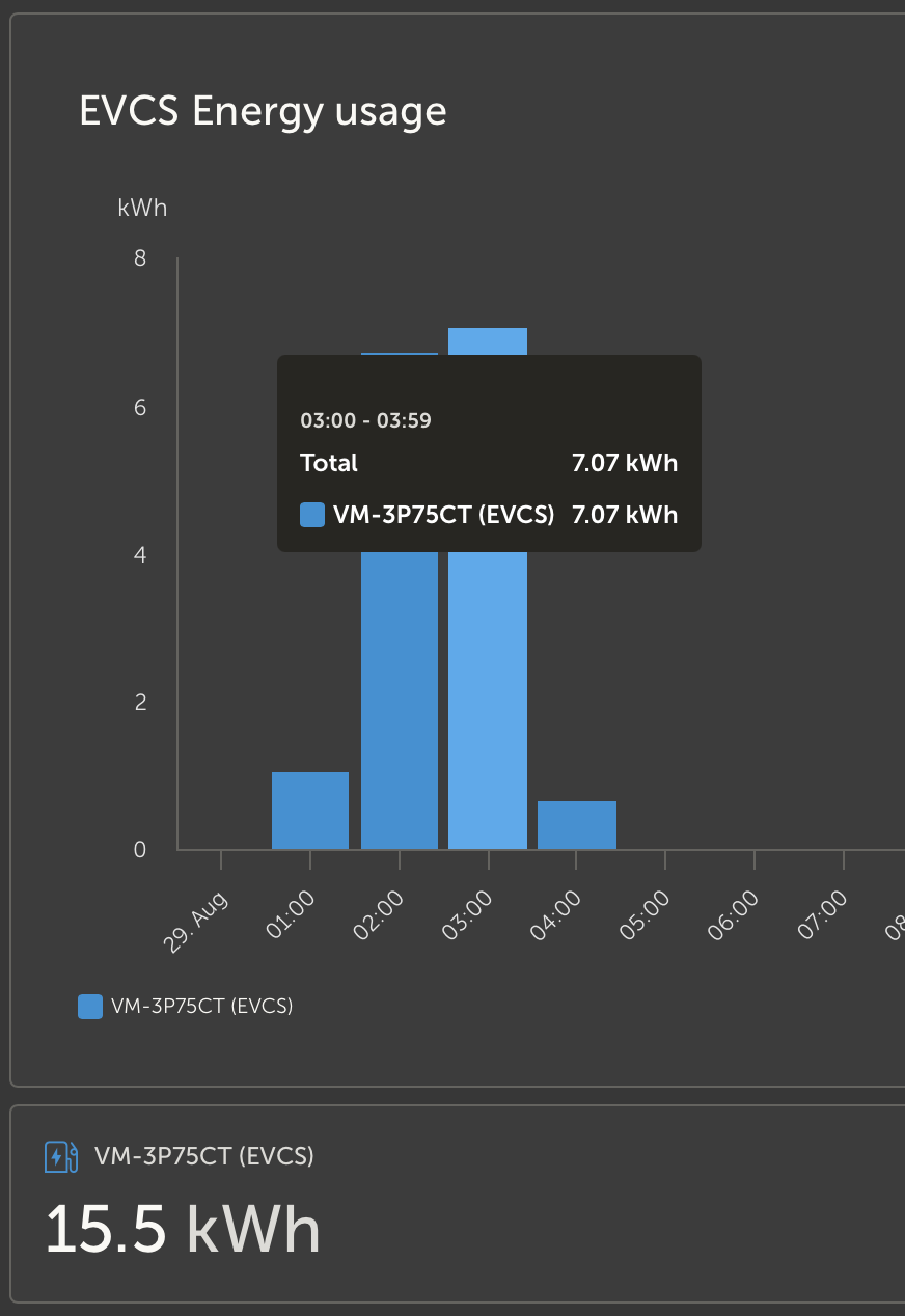

VRM is showing the short past session but it wasn’t showing it during realtime.

@jcirl I think this could be an Ethernet thing as mine shows instantly via the VE.Can. which could be the reason why yours is polling. @Luc said VRM hasn’t been updated yet which is why nothing showed on mine either regarding real time wattage on VRM

VRM is as you and @Luc describe. There is good data there, and more to come with realtime info like I see in GUIv2. Which looks great btw!
Hi @Daza I changed over the EM as you suggested from Ethernet to VE.Can and that has resolved the issue where the Role would disappear in VC. (The actual functionality never seemed affected other than this cosmetic issue.).
Ethernet was just temporary pending some extra wiring so I was happy to get this done regardless! Thanks again!
