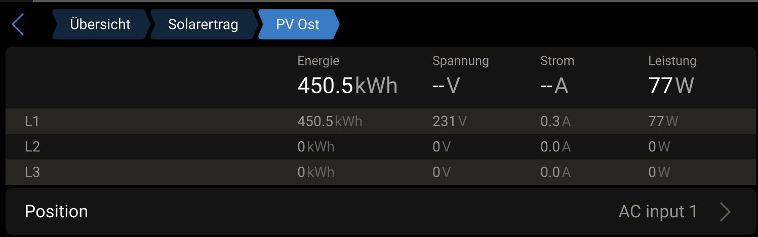

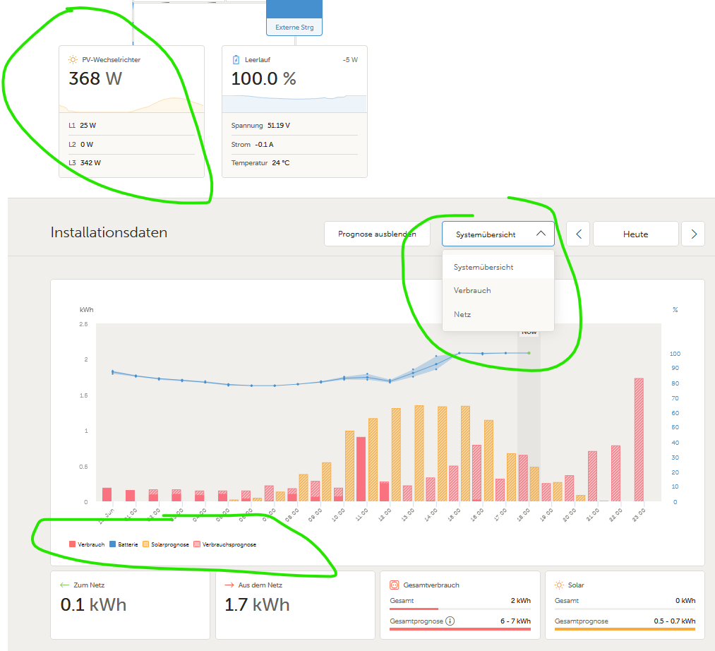

I have created a virtual PV inverter in Node-Red, which is also displayed in the Venus device overview and in the VRM portal. I can also see the curves under advanced in the VRM portal. ```
/StatusCode is set to 7=Running
Unfortunately, the solar yield is not displayed under Installation data → System overview /Solar on the VRM dashboard.
Any ideas?

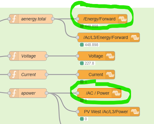

Problem solved :wink:
Not only values for the individual phases (here single-phase), but also the totals of the phases must be defined as output node, then the “Solar” field appears again in the dashboard.

Hello,

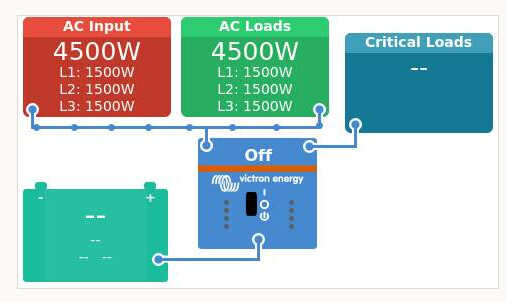

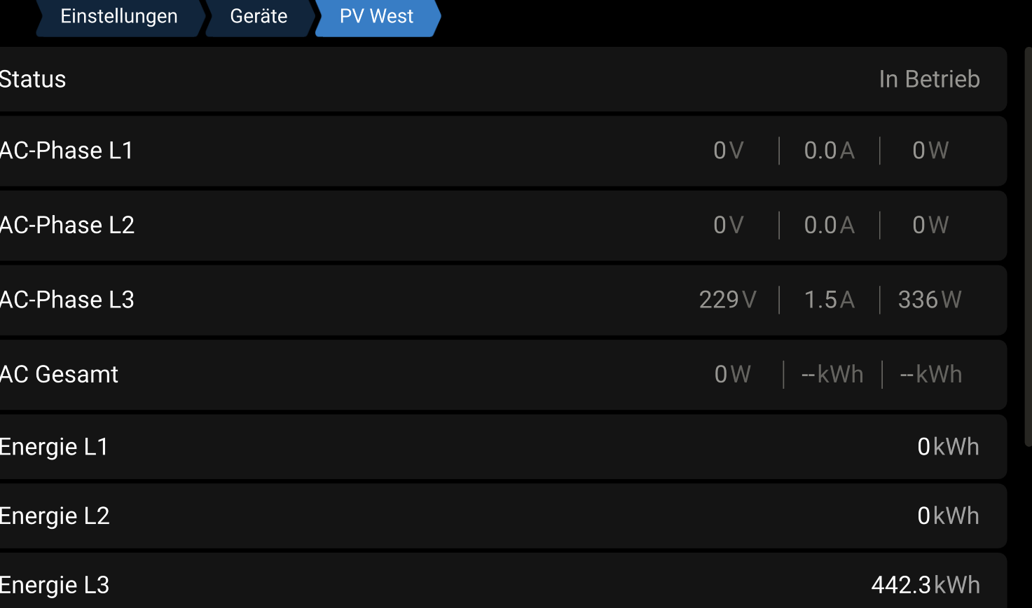

Not sure is this is the right thread, but I can get my Victron Virtual PV device being showed in the remote console and VRM.
I have connected al the virtual output devices and set status to 7. It is showing the correct data in the remote console, but not showing on the system overview.
Any idea what is not correct here?
PS
I see that the virtal Grid-meter has the same device instance (100) as this one phase PV device (als 100). From what I understood this device status should be unique. So maybe this is the problem, but I don’t know how to solve this.
Why is your inverter off and the battery field empty?

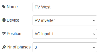

Did you use a one or 3 phase virtual PV inverter
One phase Shelly as virtuel Device in a 3 phase net.
All virtual devices have different VRM id´s.

This is my Victron DEVelopment system (Venus OS on a Rpi with no chargers or batteries connected). I would expect that that is not a problem.
I started with a fully connected 3 phase virtual PV configuration and also added a one phase virtual PV configuration (from which the screenshots are taken).
The double device number (100) are given by Victron.
Use a 3 phase virtual inverter and use only one phase
This was final the solution.

The result was the same. So virtual device was added to the device list, device showed correct values on the remote-console [Settings]-[Devices]-[xxx] page, but is not showing data on the remote-console page (classical UI) and the VRM overview page.
