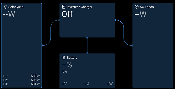

I created a virtual pv inverter for my hoymiles inverters in node red.
Configured everything that i figured out, but the overall yield of the inverter stays empty.
Does someone know what i missed to configure?
It is on my test system (nothing connected to it) - so it is okay that everything else is not showing up.
Here it shows the current production - but missing on the overview page.

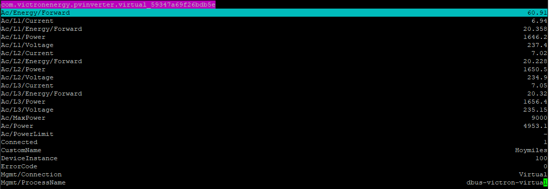

DBus-Info

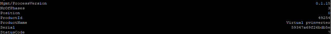

Maybe your problem is solved here: Virtual PV inverter is not displayed as Solar tab under installation data in the VRM portal - #4 by mojo2012
I had a similar problem and now it’s fixed.
ty for mentioning it - it is already set to 7 (also visible in the dbus-spy output)

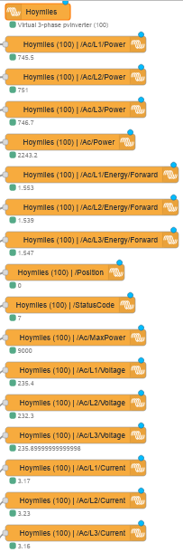

i have the following inputs set - maybe one is missing…
/Energy/Forward
Edit: I also have /Power
sry must have missed that one - had to drag them all to one side for the screenshot - but /Energy/Forward is there
interestingly it shows the overall when i directly click on it…
power should also be complete:
(some still show “connected” only because i havent received data yet)
