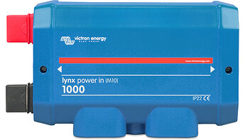

Nice setup. Can you share more details on the DC busbar that you engineered ?
Hi Jaac, I used 5 Victron Lynx Power In p/n VIC.LYN020102010, they bolt together and make the job easy.
