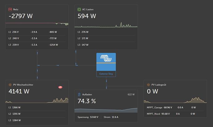

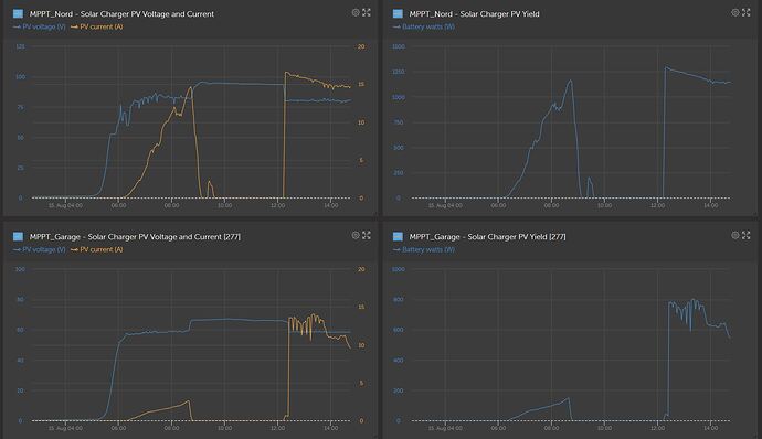

I’ve been having a problem with my setup for a while now and hope you can help me.
As soon as the CLV (53,6v) is reached, the MPPTs throttle down and the batteries continue to be charged slowly by the AC inverter (CCL = 160A). Even though DC feed-in should be working, and the Multiplus should be pushing the excess DC into the grid.
-ESS is configured (optimized without BatteryLife)
-DC Feed In is enabled
-DVCC enabled (55,2v) → JKBMS
After an indeterminate period of time, however, both MPPTs begin feeding the DC into the grid. This process repeats itself every day.

I checked the values ​​again.
The MPPT com.victronenergy.solarcharger. /Link/ChargeVoltage is no longer at 54.05V. It has now changed to 53.65V?
It looks like the value is unstable, fluctuating between CVL 53.65 V and CVL +0.4 offset. However, I don’t understand what’s affecting this.
############### EDIT 2 #############
Now I checked in dbus-spy the System/Debug/BatteryOperationalLimits/SolarVoltageOffset. It was set at 0.
I set it vom “0” to “0.4”. Now the MPPT /Link/ChargeVoltage → shows me “54,45v” (0,8v over CVL).
Although the CVL has been reached, both MPPTS are currently operating continuously.
