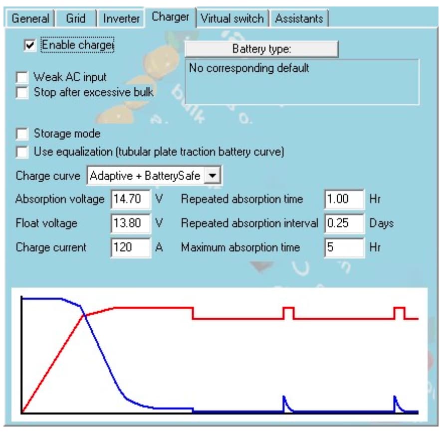

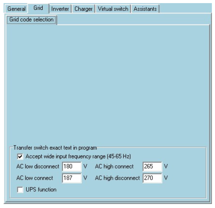

I have a Victron Quattro 12/3000/120 230v 50hz on a boat which has been installed for some time and working without issue. Recently, it has stopped charging the batteries when the generator is run. It does show 230v on UIMains but it simply won’t charge. This is an older unit with the version 19 or 19 microcontroller so I can’t run a VE.Bus to Bluetooth module to see the unit. I can plug into it and use the older Victron software to configure it (using MK3 USB adapter).
So far I’ve done these things:
- verified 230v is getting to the unit

- when I use the remote switch to toggle it between on (inverter)/off/charge only, I think the mains blue light blinks ~15 times when turned to charge and then nothing happens

- is there any way to get some kind of information out of it on WHY it is not charging? right now, the unit is on and the inverter light is on but that is it – no useful information from the LED lights
