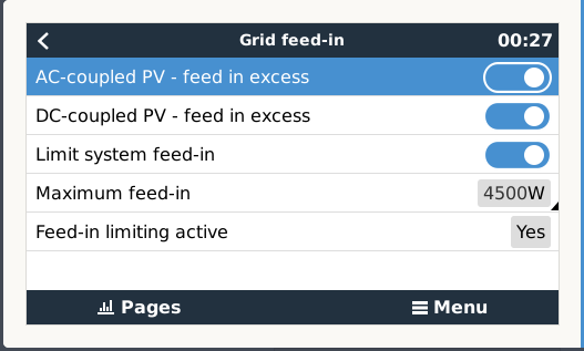

but the read value was always 0…while with the VRM remote control was showing the value 3500W, which I set manually..?

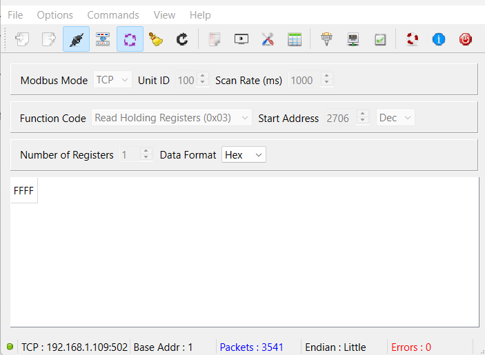

I decided to check the Modbus TCP readings in another way, so I used the QModMaster modbus TCP client to read the register 2706
As it is shown the read value is 0xFFFF, which can be interpreted as -1 (no maximum grid in limit) but in reality the currently set value by the VRM remote control is 4500W
There is some issue… a discrepancy between the Victron XLS files with the registers and the actual behavour of the Cerbo GX? Can you please help me?
