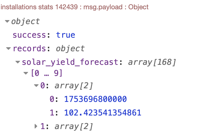

We are using the Victron API node for PV forecasts for the coming day. Appears to work great.
SO is there a way to get a week or at least a few more days of forecasts as simple day totals?
Full 24 hour day totals ideally. Grateful for any hints on how to do this. Many thanks.
If you are using the VRM API node it should give you the option see the forecast +24 +48 and 1 week.
Thanks @Sean.m
I have experimented with it and it does not do precisely what I want.
I want daily totals for one week forward, as text.
I have that working with an old flow that connects to Solcast directly, but need to migrate it to this at some point. Don’t suppose you are doing something along those lines by any chance?
