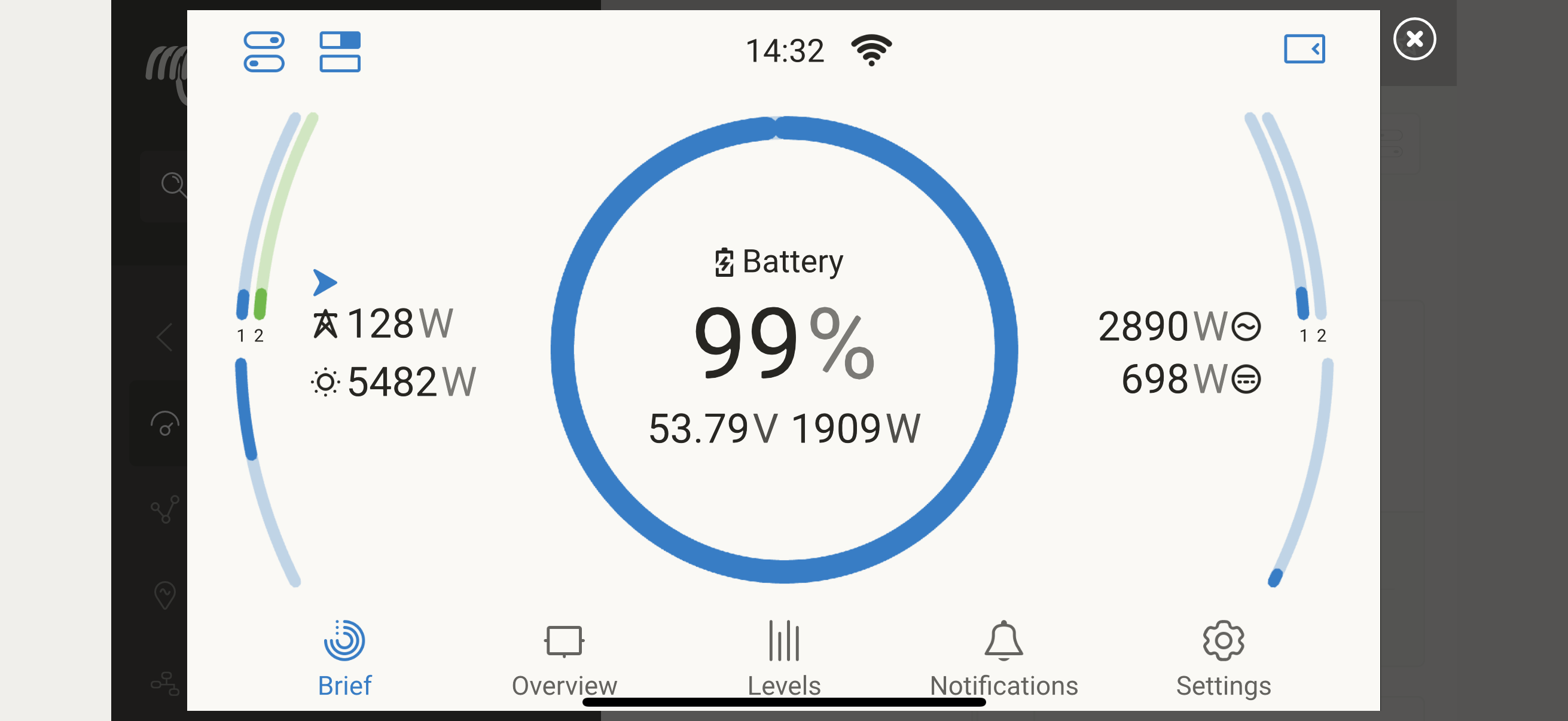

We have a VM3 meter in a split-phase configuration, under a PV inverter role. When looking at the meter on the local console, it is shown with one line (phase). When looking at the remote console, it’s shown with 3 lines (phases).
I believe it should show 2 lines, similar to how the AC Input and AC Output sections are shown?
This isn’t a new issue, but finally flagging it. The VM3 is on 1.10 firmware, and the Cerbo GX is on 3.65, and both are connected via VE.Can.
Thanks!
Note: These are screenshots from when I was testing 3.70 beta, but the issue exists on the 3.65 stable release as well.
