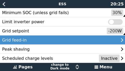

I updated my GX to v3.63, but still DESS is not respecting my negative grid-setpoint. I would rather feed to the grid from the battery, instead of taking consecutive gulps from the grid.
Where s the battery2grid restriction? Is it the “Can you sell energy back to the grid?” in the VRM DESS settings? - set to “Yes” in my settings.

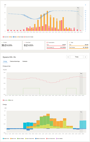

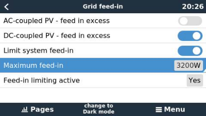

Thanks for the note about the upcoming release! May I point out that the grid feed-in limit is also not beeing considered by the DESS calculations. I limit the battery-to-the-grid to about 3 kW, to be easy on the battery during such cycle phases. Whereas DESS is still considering it can discharge at 5 kW, the forecast is therfore quite off.
Hmm to answer that I would need to look into details. The Scheduler should only plan for a 3kW discharge, and additionally the local system will limit the requested rate to 3kW as well.
What the scheduler ofc. may plan anyway is discharging with 3kW and feeding in 2kW from solar, leading to a combined feedin of 5 kW.
May that be, what happened?

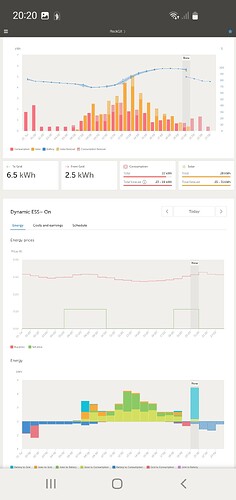

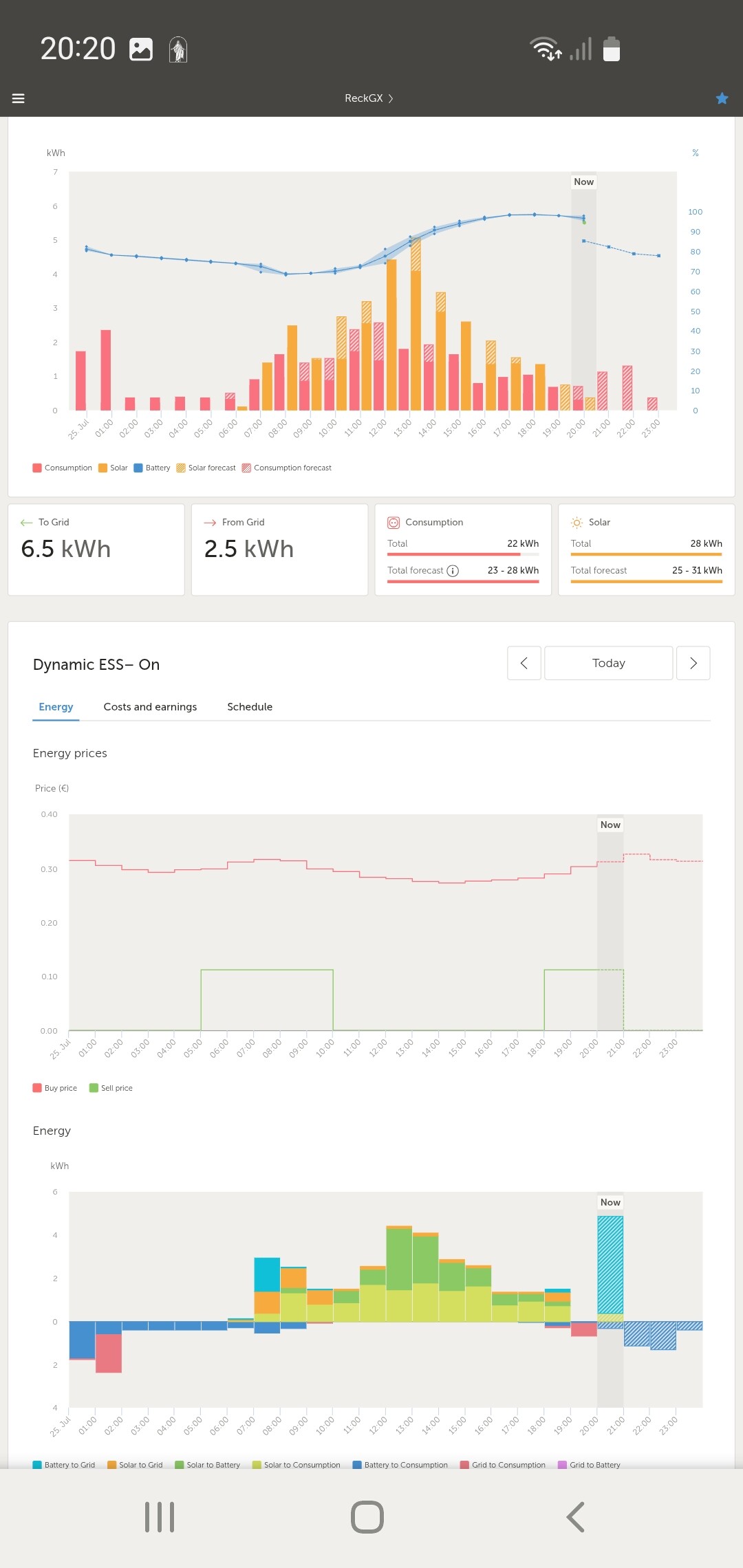

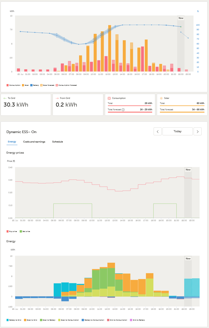

The scheduler plans more than 4 kW grid feed-in but then the set limit does not allow it. This means my 40 kWh battery is not discharged enough according to the plan, and then is already full at noon. An additional wish, is that a lower-limit, like 30%, can be set to avoid the grid feed-in to drain the battery, leaving some reserve.
See screenshot of today.

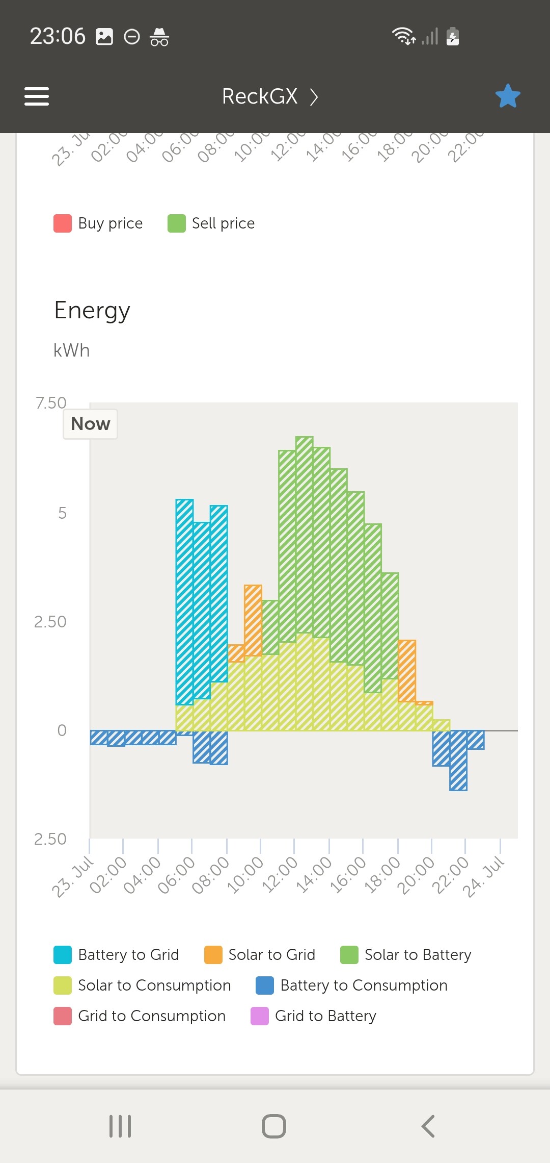

And this was the plan for today, I captured late yesterday night:
So, where did you set what kind of limit?
If you set a maximum battery discharge of 4kW in DESS, the scheduler should not create a discharge above that. (If that happens despite a set limit in DESS, I may forward this to the scheduler team to look at it)
If you want it to discharge more, then why you set a 4kW limit?
If you set local limitations, like the Inverterlimit or AC CURRENT limit, DESS is not aware of these.
My ESS has no “Limit inverter power” set.
Today another anoying problem is showing - with a nearly full battery, the DESS is drawing from the grid - fully unexpectedly (at 1AM where the heat-pump kicked in), and again at 7 PM, just before trhe plan to feed into the grid - which it is doing right now. This means I paid today 0,80€ without necesity. Most other days because of the disregarded “Grid setpoint” it is consuming around 0,4kWh from the grid. In a yearly total I will be paying over 40€ - which makes me decide to turn of DESS and wait for the VenusGX update with some fixes.
