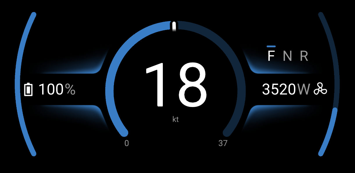

Hi all, we’ll share more info for how to get the data in there later.
Simply put there are three options:
  • N2K PGNs, requires a motor that sends data in NMEA2000 format
  • Install a SmartShunt and set it to be a measuring current in/out of a motor
  • Use the new virtual motordrive node in Node-RED and somehow get data in there (make your own flow and code for that)
We do not support canopen. And don’t have time to work on that any time soon either.
Suggestions are noted

The software adapts to the available data.
No config is possible.
Available data is combi of smartshunt, motordrive can connected (n2k), gps

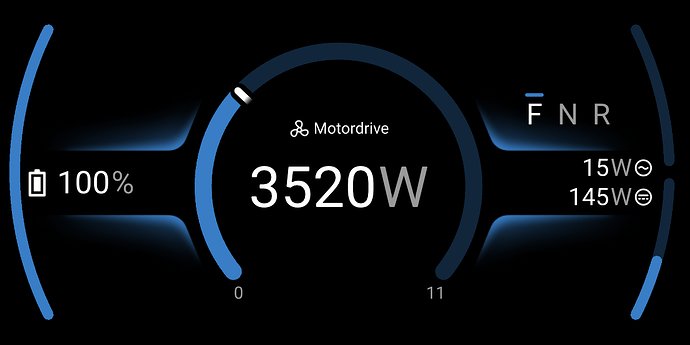

Thanks Matthijs. So can Smartshunt power be selected as the “central parameter” on the boat page display? And same question if the node-RED virtual motordrive is used – and how about rpm in this case?
If you add GPS speed to the mix it will move watts to the right
How do you choose what is “added to the mix”? I have a GPS dongle plugged into the Cerbo so this has speed/location data available, but I certainly don’t want this to take priority over motor power – or rpm, if that can be “added to the mix” using Node-RED… :wink:
It should be simple to make the boat display configurable, even if only selecting what the big central reading is, so I’m surprised Victron haven’t done this.
As per Matthijs previous message, you don’t, the software adapts to available data.
It would be good if this could be configured, similar to how you can configure the brief page.
Such configurability is really a necessity for it be be actually useful in real life. For example the GPS on my boat is only ever used for location tracking (including geofencing) not speed, so I need it to be visible to the Cerbo for that purpose – but certainly don’t want speed to be the central feature of the boat display, I simply don’t care about it, where I really do care about power consumption since this is fundamental for an electric boat.
Even if this feature isn’t on the initial release of the “boat display” feature, it should certainly be a high priority for the next one… :wink:

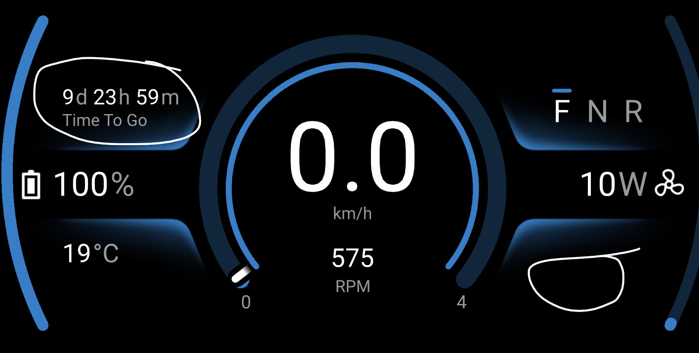

Hi,
playing a bit with the view…
In my case the Time to Go is flikering… and sometime not coming up…
Remain the left bottom field to discover…
When I was talking, previously to see with some others devices like the ACE automation, The principle/goal is t be able to simulate the motordrive device and see if it is possible to get my truck parameter instead with the according registers… Some kind of fake motor drive…
Xavier.
Time to go is flickering as you are not pulling any load from the batteries.
OK, solved !!!
