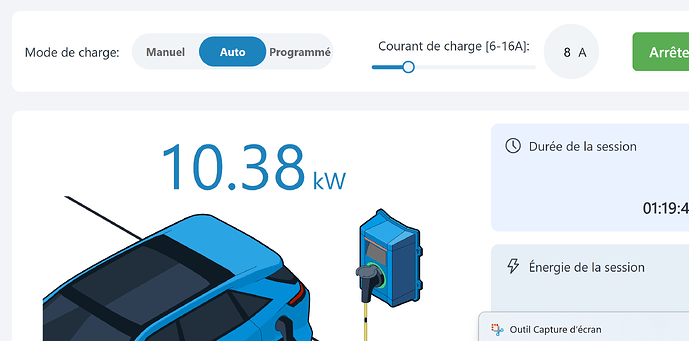

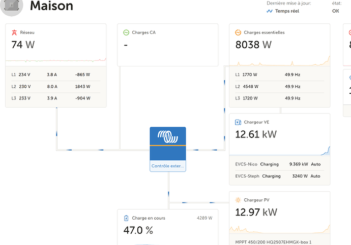

I made the modification to add automatic switching between 1P and 3P. It works perfectly, and I’m very pleased with it. However, I’ve noticed a bug in the consumption calculation.
The power allocation calculation is correct (the battery charge varies with the sunlight, but is managed properly). However, the charger reports consumption of 12.61 kW and total consumption of 8038 W, which is inconsistent.
When I go to the EVCS, the displayed consumption matches what is shown in the VRM (the difference is due to the adjustment between the two screenshots). However, it reports consumption of 8 A on three-phase 400 V, which gives a consumption of 5500 W and does indeed match the actual consumption.

Good afternoon,
With the Buzz, L1 is also indicating lower as I calculate.
That means the L1 inverter output calculation is not correct, so the internal measurement is off.
You can solve that by using an external CT as the internal one is NOT possible to adjust, or, to use a 3 phase meter from Victron or Carlo G. to be more accurate on the MP2 outputs.
Ask your supplier/vendor if this is something for a RMA as well, maybe they give you another one?
