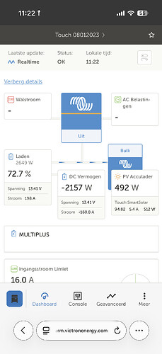

Strange reading in DC current and charge current
Suddenly about 2000W shows up as DC current and as well is added to the charging?!?
12V system has Lynx setup with shunt and a second shunt as energy meter for wind generator and mppt controller with solar.
What could cause this?
The DC box is a calculated value, the attached link explains this. What has happened is your Lynx shunt that supplies the battery current is reading nearly 200A coming inyo the battery, so the GX device calculates that this is unmeasured current from the DC system. You need to investigate the Lynx Shunt. Has one of the current sense wires come loose.
