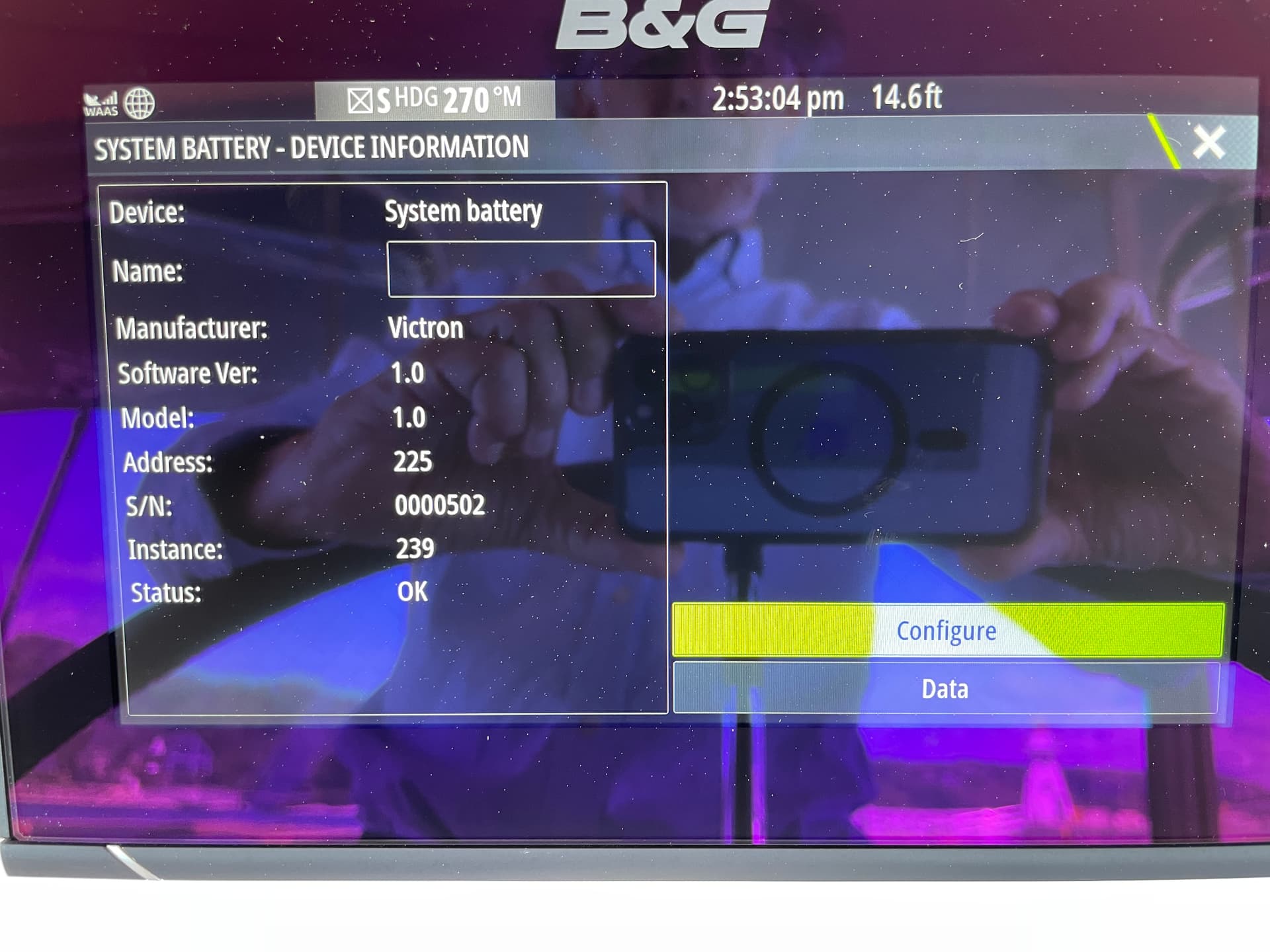

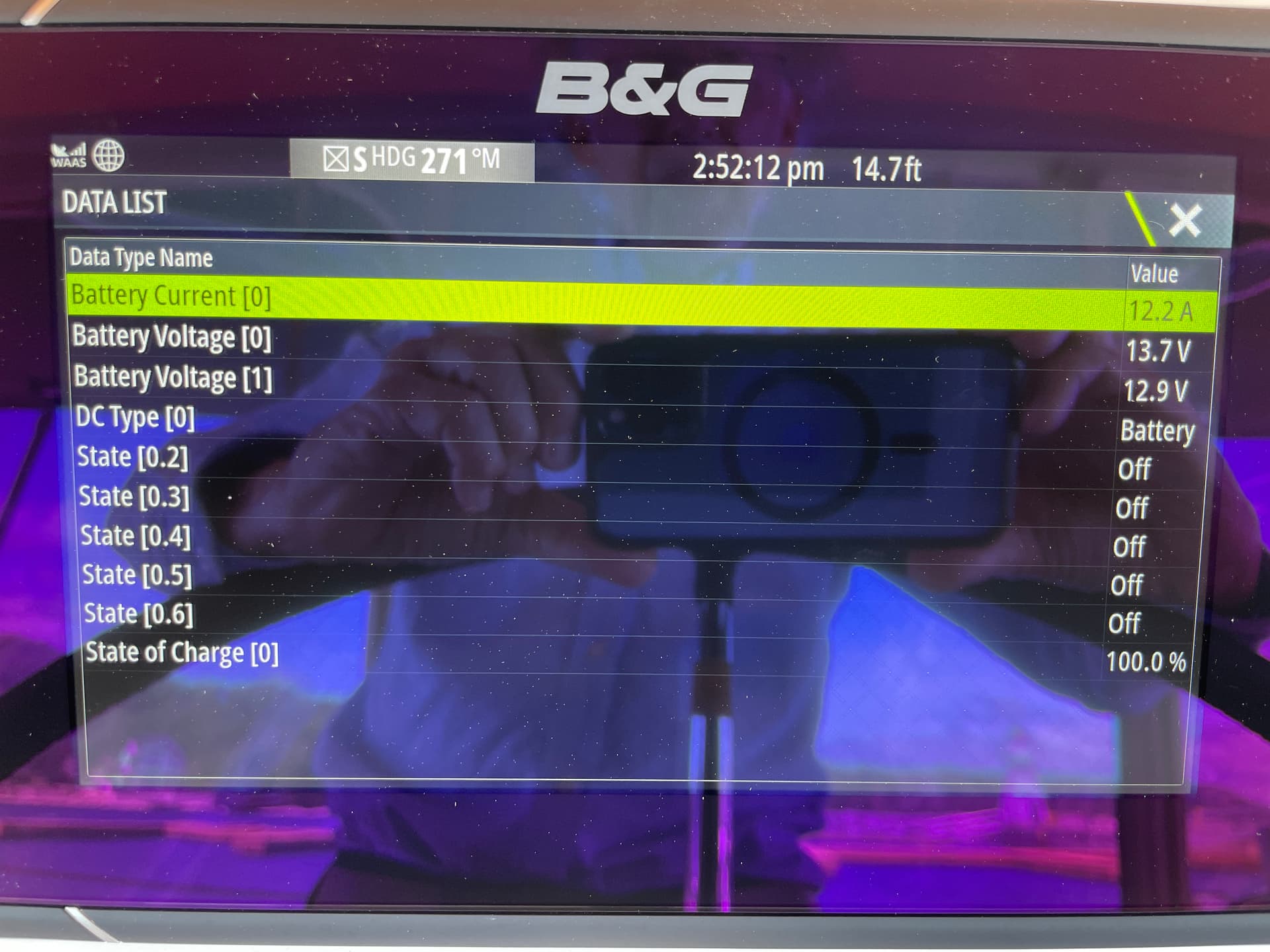

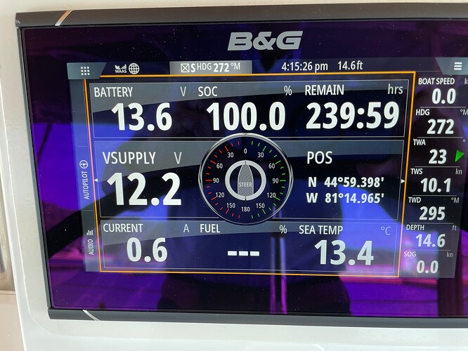

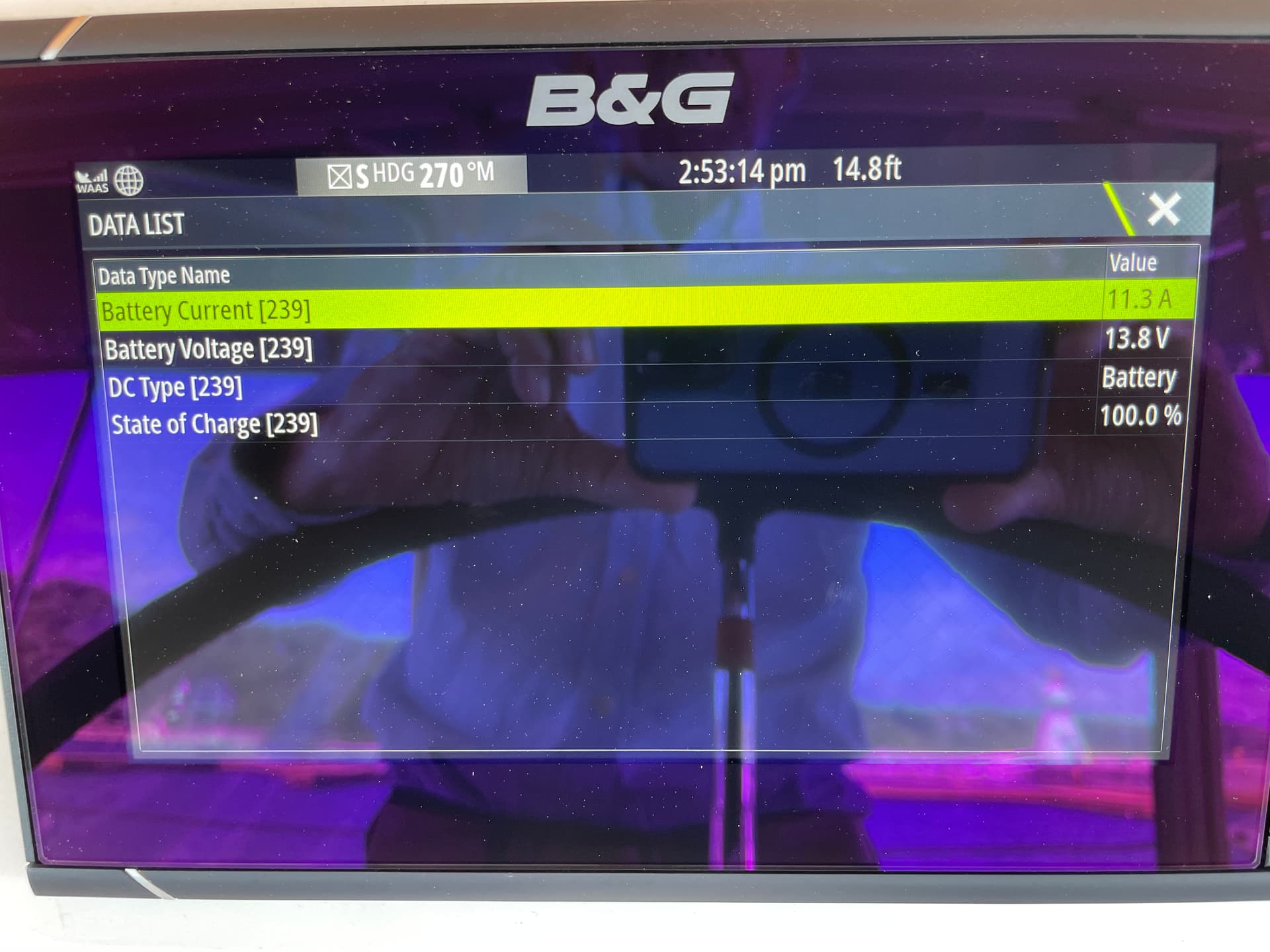

Some more info about my issue. The MFD did receive more data than it displays. The shunt battery info for the house and starter are shown on the devices data page ( photos attached). There is a separate data page showing the “system battery” which is the lithium house bank. Does anyone we know how to get the starter voltage to display on the instruments page? The photo of this page shows the “supply voltage” which does not agree with the starter voltage. Thanks for any help!!
I have read some posts, like this one,
that have a similar, but not exact, problem. Could my issue be solved by changing a data instance number? In my case [0] is used for the house battery voltage and [1] is used for the starter ( see above). This post says [1] cannot be used?

I’m 99% sure that what you need to do is change the layout of that page in your B&G MFD.
And no need to get into changing instances.
This thread may help out: Cerbo Gx and NMEA2000 PGN's

Hi BDN, So I think they added the ability to change this with in the GX software. I have mine set to Port = 2 and Stb = 3. This seems to work fine with Garmin and Raymarine. Maretron also works but you need to set the instance manually in their UI.
Here is a Victron reference page, pretty good info, except that the newer Raymarine and Garmin also needs valid instance numbers as well.
But take a look at this and hope this helps!
