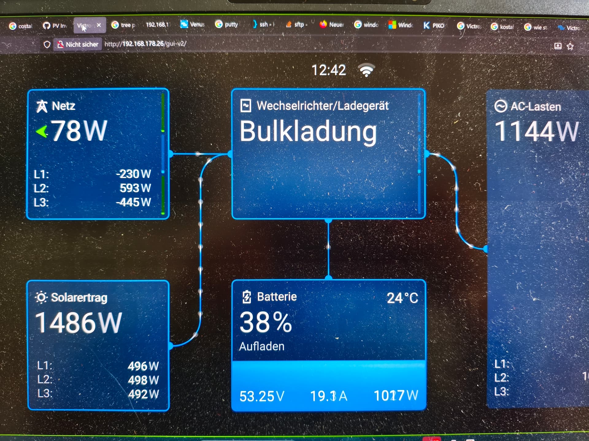

Hi, I just added an inverter via a git repository to a Cerbo with version 3.66.
PV Inverter works fine, but the caclulated AC-Load is wrong.
Dont know if it is a Cerbo poblem or a repository problem.
It appears that the Cerbo does not subtract the battery load from the AC load.
Fixed!
Solution:
MP2 was running on L2.
After switching L1 everything is working correct
