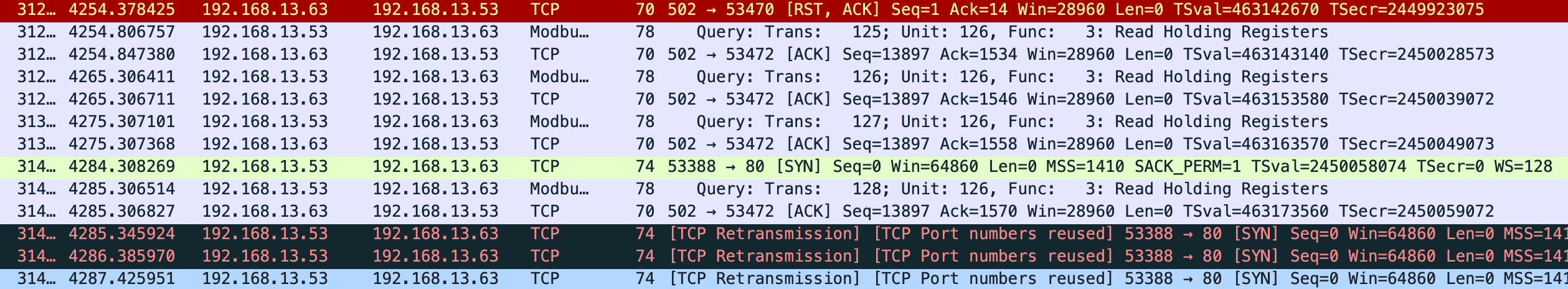

@iburger you probably have seen the ACK, RST being sent back from solaredge right before it stops responding right? I understand the RST as a termination of the IP connection, but Venus still tries to use it? Or am I mistaken? Maybe a filter on packets was applied in the screenshot?

I did some Wireshark captures, in One thing that stood out is that it seems my Cerbo is trying to acces the SolarEdge inverter on port 80. AFAIK there is no server running on port 80 since a few years now,. Whenever this happens the dashboard seems stutter on the SE data. I also see some unexpected sessions on the modbus port around when that happens. specifically an older session is being reset, [RST,ACK] and the activity on the new session gets stuck up.
After a while a new modbus session is created but the old one is not closed properly, which only happens after a while.

I have, on that one site. It doesn’t happen every time, and not on every site checked, so it is unclear if it is part of the problem. I think it’s unrelated.
RST is sent when a packet is received that doesn’t seem to belong to any known connection. It also doesn’t fit with the pattern that later packets are still ACKed, indicating that there is no problem with connection tracking. I am therefore inclined to dismiss that.

Analyzing from the wireshark traces, the RST is sent by the SolarEdge device after a while for a connection which runs into time-out. The RST is seen on an older session, which is not being used by the modbus client at that time. After the RST it seems (at least on my system) that the SolarEdge is not responding for a while, which seems to cause the new session to start. Maybe this is of help to the debugging.
