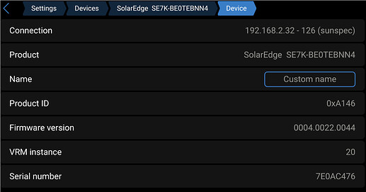

• SolarEdge SE7K-BE0TEBNN4 on AC OUT1 (firmware 4.22.44 and ip-address: 192.168.2.32)

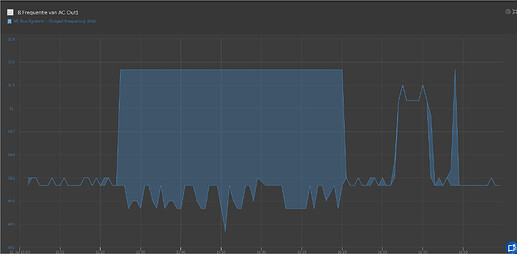

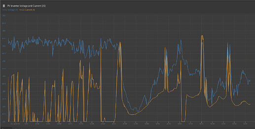

All attempts resulted in ‘pendling frequency behaviour’ as can be seen in:
(left part, min-max enabled in the widget)
However, disconnecting AC 1 by a switch, results in AC OUT1 going into ‘emergency power mode’, without even restarting the SolarEdge, but just continues directly after getting 3x 230V !!
(right part of picture above).
So, some difference exists in hardware/software disconnecting!

This solutions reduces the downtime of the solarpanels, as can be seen as follows (left part, until 13:15 hour).
However, playing around with the DESS settings:
– system → maximum import power: 2kW → 3kW
– battery → maximum charge power: 2kW → 3kW
it will work even better, because in case of disconnection of PV, will start loading the batteries from the grid and lowering the (internal) overvoltage. After that, PV is reconnected (right part, after 13:15 hour).

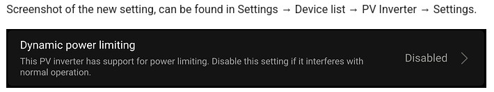

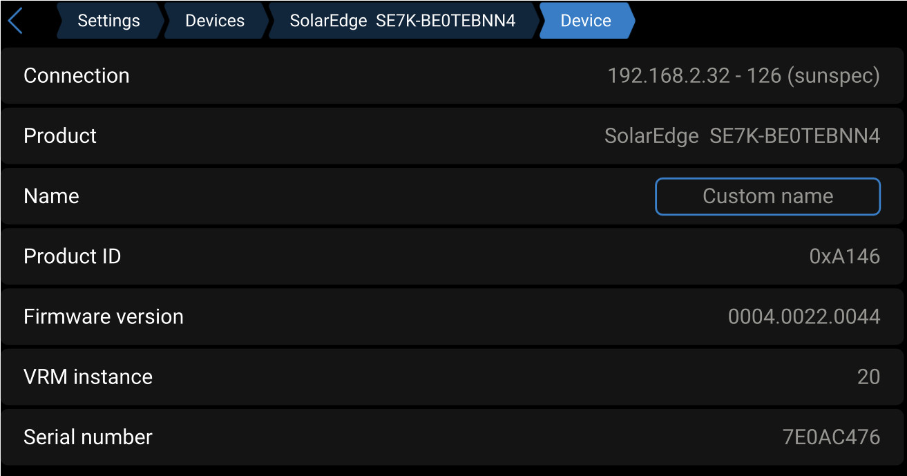

In this case, the SolarEdge will be controlled by the Cerbo GX in stead of manually manipulating settings as described above. Trying to use this solutions is not working in my situation, because the option:
is missing!

It looks like the SunSpec connection between Cerbo GX and SE7K is only monitoring/reading registers, but not writing in the register to control the SE7K?

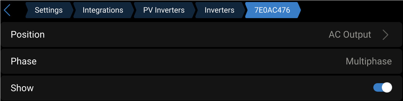

Hi there. I have nearly the same setup as yours. I managed to use the “Dynamic Power Limiting”. So far everything seems to work.
3x Victron MPII 5000
–> 12x Voltsmile V10 RPC & MPPT 250/100 (with 5,4 kwP)
—> SolarEdge 12.5K on AC-Out
I update my SE12.5K last week.
I had to reconfigure the Solaredge Modbus TCP Configuration (Chapter 5 from here: Integrating with SolarEdge [Victron Energy] ).
I also configured the frequency shifting & Solaredge APS switching wenn offgrid (described in aboves link)
Victron Config:
  • Switch for Solaredge APS wen offgrid (Assistent 1+2)
  • Go offgrid wenn input AUX1 is used (Assistend 3-5)
Import:
  • I used the the Victrons AUX Relais (NO + COM) to interconnect to Solaredge Communication Board (L1+V).
  • I also deleted the SolarEdge Smartmeter Config (i think you can also just deactivate the Smartmeter) & the restarted the Solaredge Inverter. (For some reason the dynamic power limiting didn’t work with the SE Modbus Smartmeter configured)
Last steps:
  • Restart the CerboGX
  • Configure the “dynamic power limiting” for SE

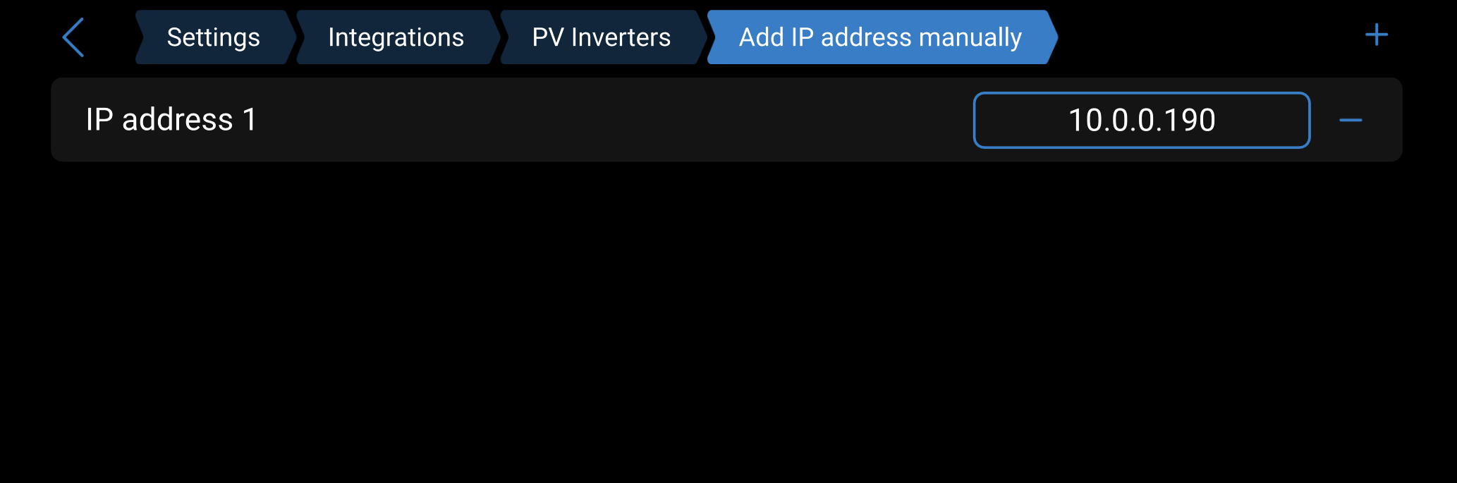

Hint: I didnt configure the SolarEdge inverter as “Modbus device” but used “Seeting > Integrations > PV Inverters” and also entered the SE inverters IP manually in the config, and didn’t use the “auto scan function”
