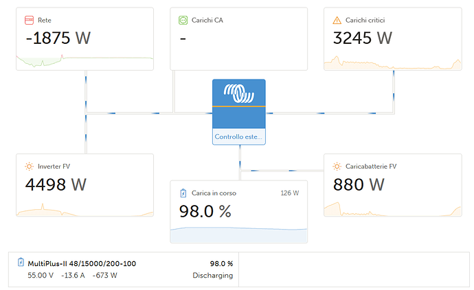

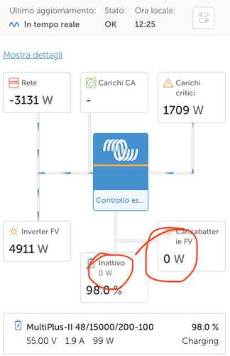

Hello everyone, in this system (see images) the Victron SmartSolar MPPTs are reducing their power output because the SolarEdge SE6000-H system is already meeting the demand. This leads to less energy being exported to the grid from the SolarEdge system, which in turn reduces the client’s revenue. Essentially, the two systems are “competing” to supply the loads, and the Victron system is backing off when it sees the SolarEdge system handling things.

  1. Victron producing only 880W and SE been used for loads and export
  2. Victron stopped producing

I dont think you can solve this… because the system cant control the solaredge output, but only the mppt’s and the solaredge is feeding critical loads now

Its related to ess settings/dc grid feed in
Dont think it matters if you change loads as shown, it measures grid and sees ac feed in and loads powered (from ac pv)
