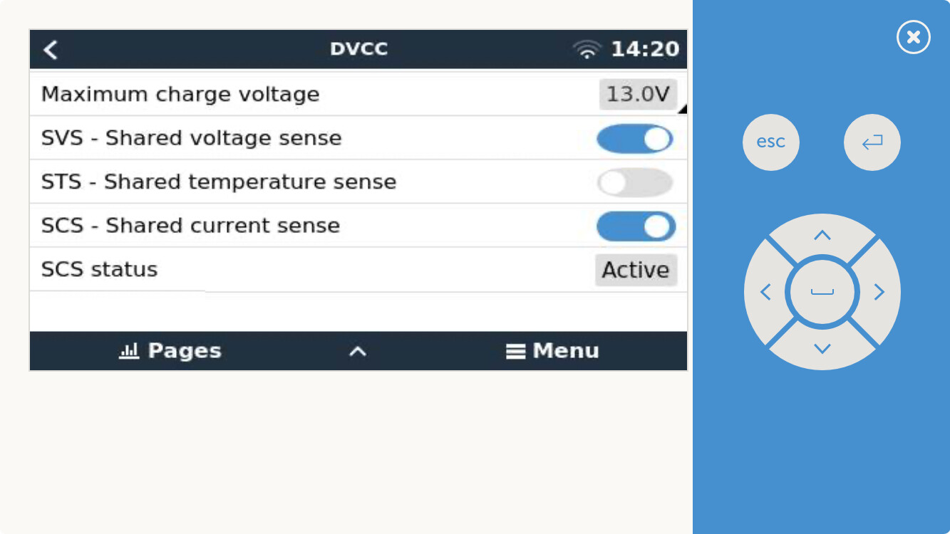

So when enabled it looks like this?

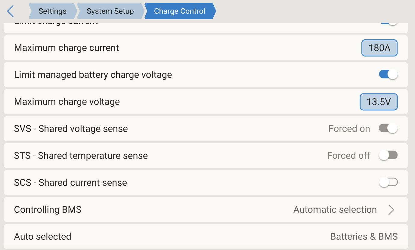

DVCC, Limit battery voltage only works like you are expecting IF the battery BMS communicates with the Cerbo GX and sends CVL, CCL and DCL that are then passed on to the connected chargers. The BMS also has to be set up as the controlling BMS in Settings > SYstem Setup > Charge Control. This is all explained in the DVCC Section of the Cerbo manual.

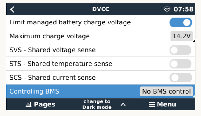

Thank you all for replying. Yes that explains a lot. The way I understood the manual was that the BMV-712 sufficient for the DVCC to work in that way. From your screenshot, pwfarnell, I can see now that the Controlling BMS section is not showing on my system, which is obviously crucial. I didn’t know what I was missing :blush: …so to speak. Thanks for your help.
You go right down to the bottom and select no BMS control, and then it works.
Makes sense, but I don’t have the “Controlling BMS” item. Firmware is up to date. Probably because there is no BMS available to Cerbo.
The newest version I am running is v3.54. I wonder if you go back, it might be there. Maybe it was removed. But you need to select no BMS control for it to work.
