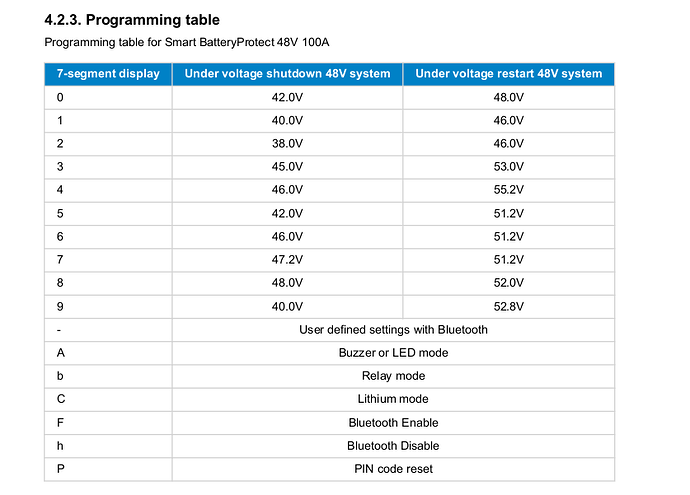

Selectable disengage / re-engage voltages with the PROG pin setting for the non-smart BP don’t go as low as I would want, the lowest is only 38v/46v.
With the Smart BP 48/100, can the disengage / re-engage voltages be set to something as low as 32 or 33 volts, over bluetooth Victron Connect app? Or does it use only the same voltage threshold values as are selectable by the PROG pin configuration method?

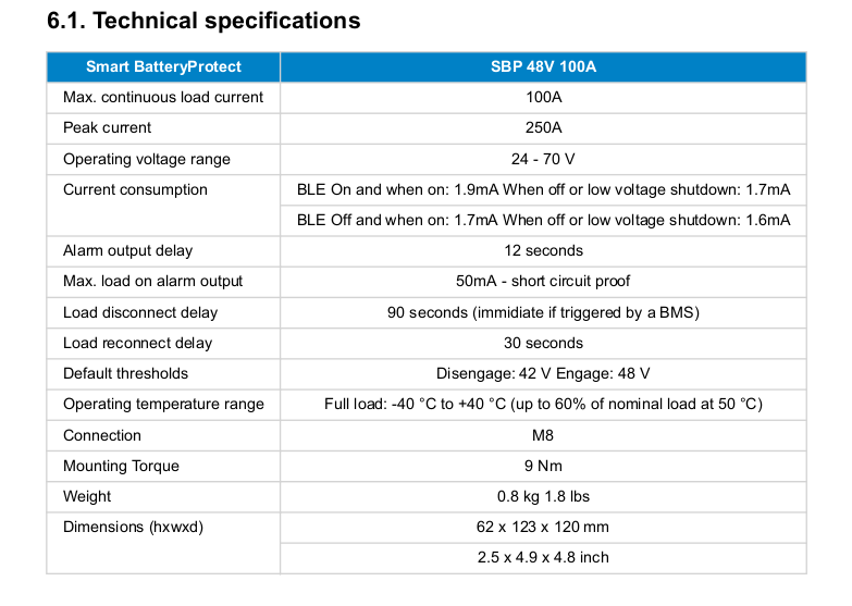

From the manual, I would expect these voltages to be set, using custom (user defined) mode & bluetooth, anywhere between 24 and 70V. Perhaps someone who has used on can confirm?

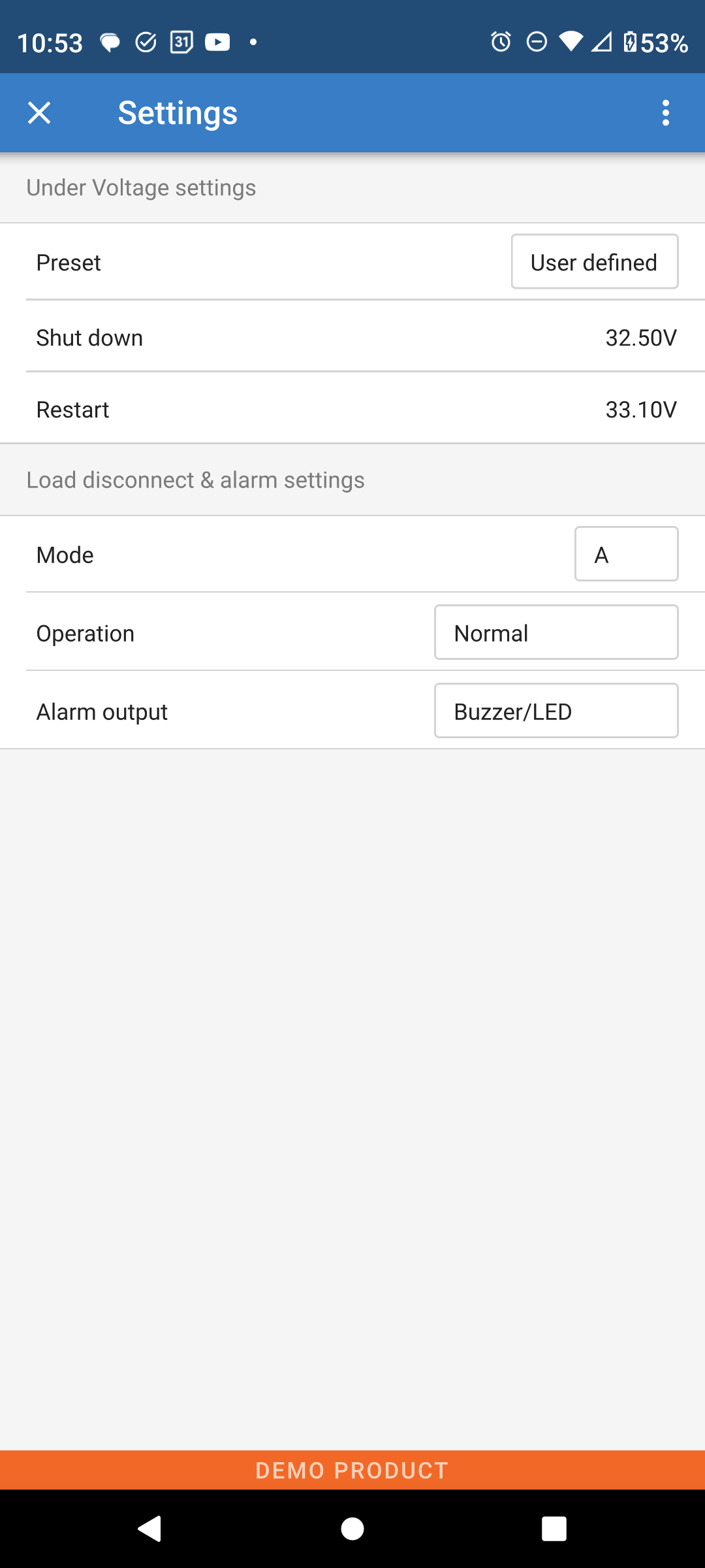

Ahah! I just learned that the Victron Connect app has a demo mode. And that shows that yes, the user defined thresholds can be set like I would want.
