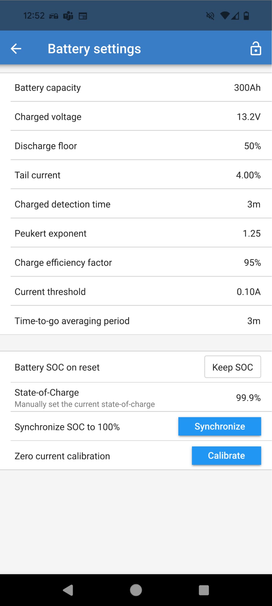

Hello,
This my mppt configuration:
This is my smarthunt configuration:
Could you please tell me what values to change? It is not clear what I need to change after reading the links. Thanks!
Best regards,
Josue
Thanks! I have done the changes, tomorrow I will check how the shunt is behaving.
Thank you all! the issue is solved.
