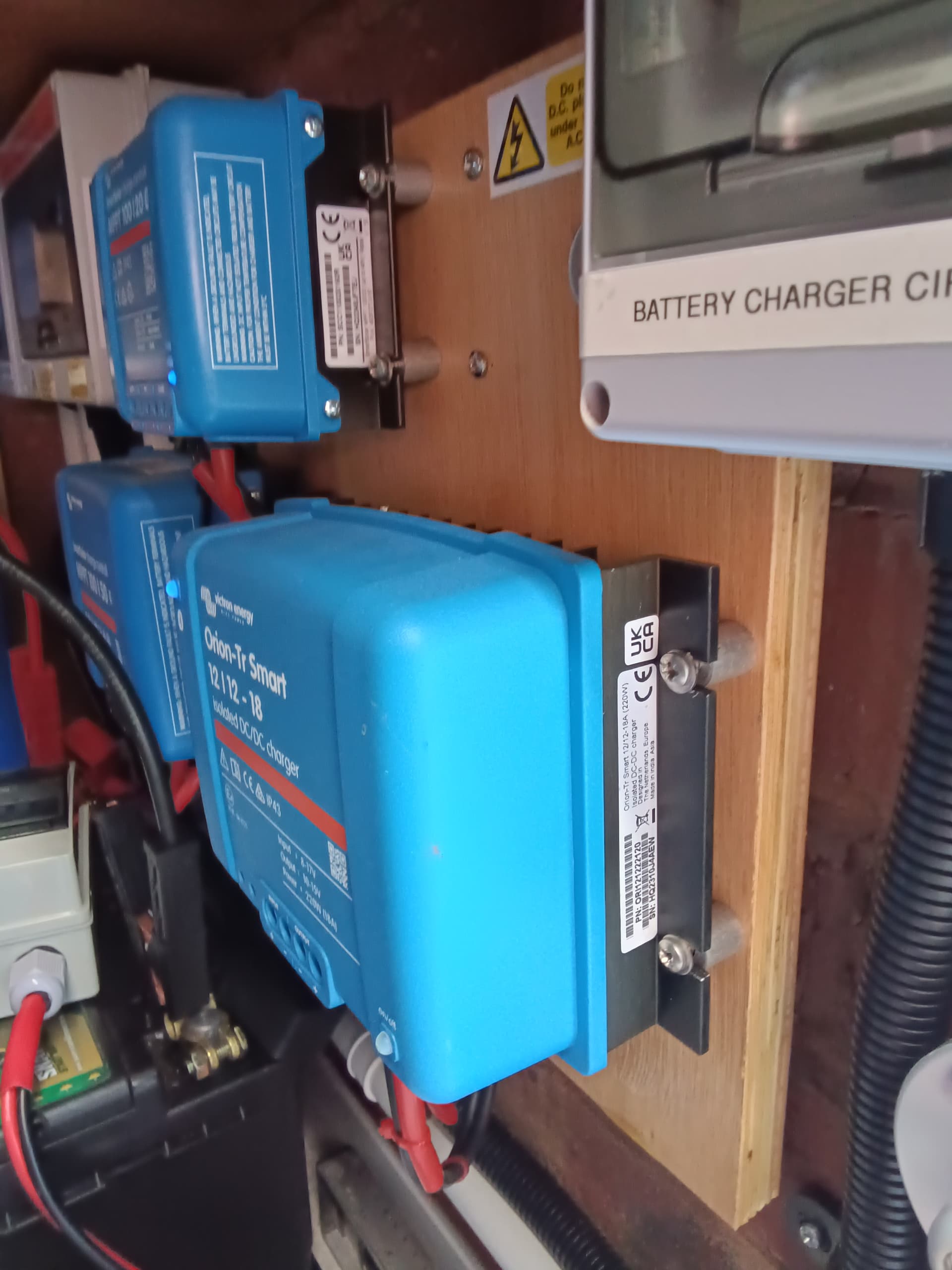

I noticed that my MPPTs were getting fairly warm this summer so I made some 10mm deep aluminium spacers to go between the MPPT and the mounting board. I was surprised at the effect it had on improving the convection cooling of the units.

Very good. Do you have any comparative figures?
I did have a stick on thermometer on the heatsink of the 100/50A MPPT and with a air temperature of 26 Celsius the heatsink thermometer was reading 37 Celsius, after I fitted the spacers the highest temperature I noticed was 31 Celsius with an air temperature of 25 Celsius.
I also connected an additional 2 x 120 watt PV panels to the MPPT after I fitted the spacers. So the MPPT was working harder after the spacers were fitted.
I would add that I don’t know how accurate the stick on thermometer is, but there has been a noticeable improvement in the heatsink temperature when PV panels are in full sun.
