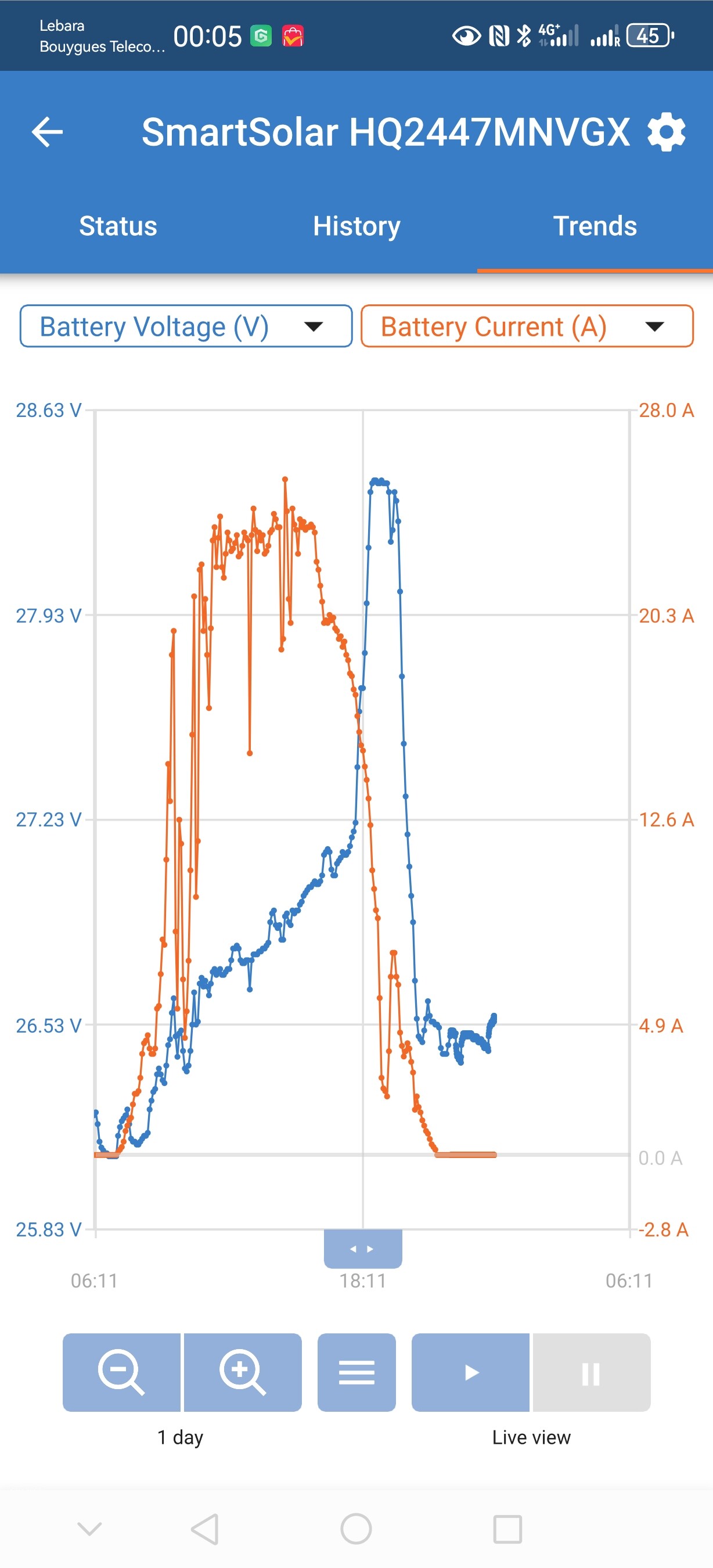

This is the output, misty morning but then full sun all day. The graph looks flat for the mid part of the day, is that normal or does it look like it’s being limited? I’ve got nothing to reference it to because my last controller wasn’t a victron.

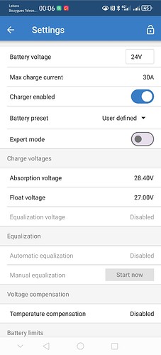

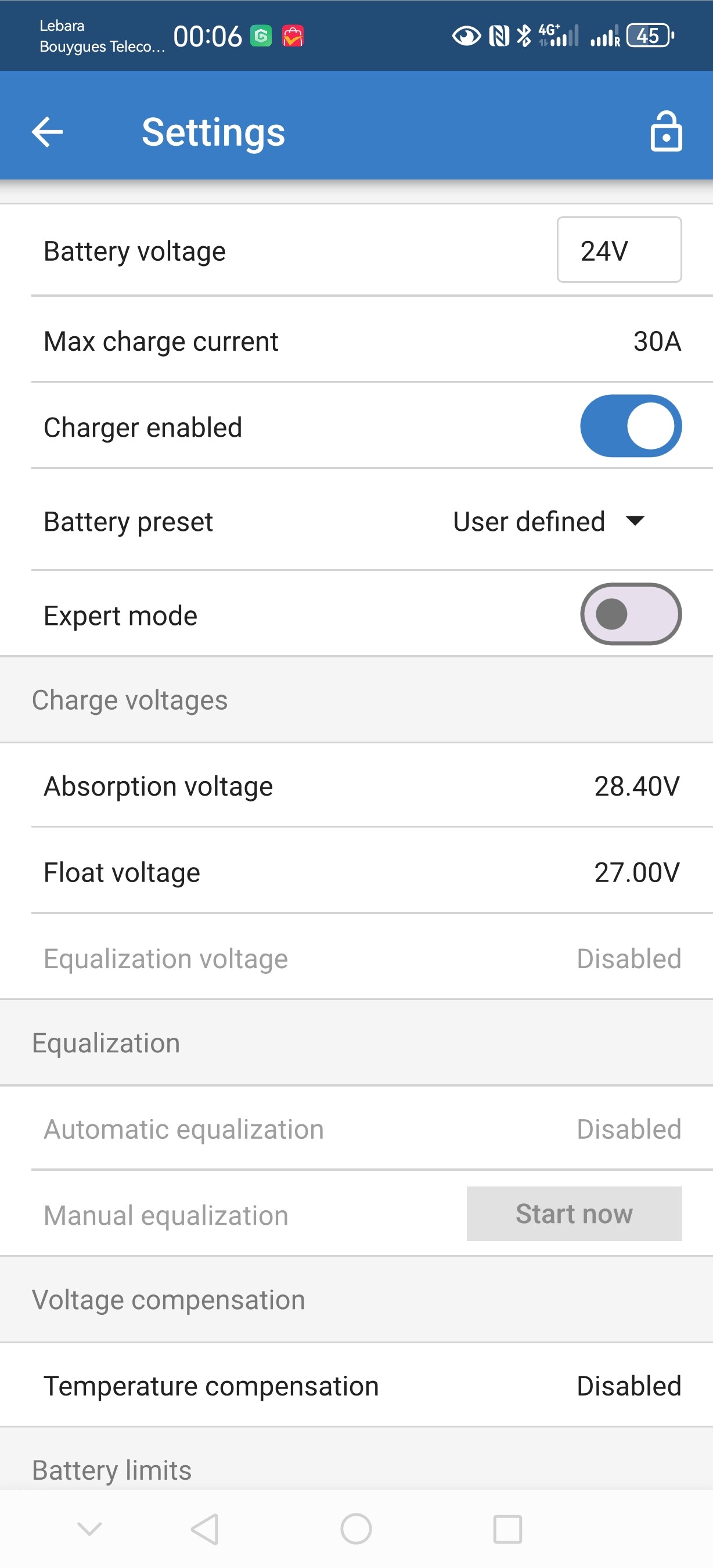

The critical question is what is the output voltage of the controller when it is running at 25A compared to the absorption voltage in the settings. If it is under absorption voltage then the MPPT is limiting, if it is at absorption voltage then the battery or MPPT to battery cabling is limiting. Show us a screenshot of the status page when this is first happening during the day and you battery settings.
Does this help? These are all from today, full sun after morning mist cleared, batteries at 38% victron lfp 200ah # 24v reached 100% by the evining but didn’t reach float.
That definitely confirms that it is not the battery or battery cable limiting the power. It is therefore either the mppt throttling back due to temperature as discussed above or some issue with the panels or panel cabling. See if you can blow air over the MPPT to cool it down.
