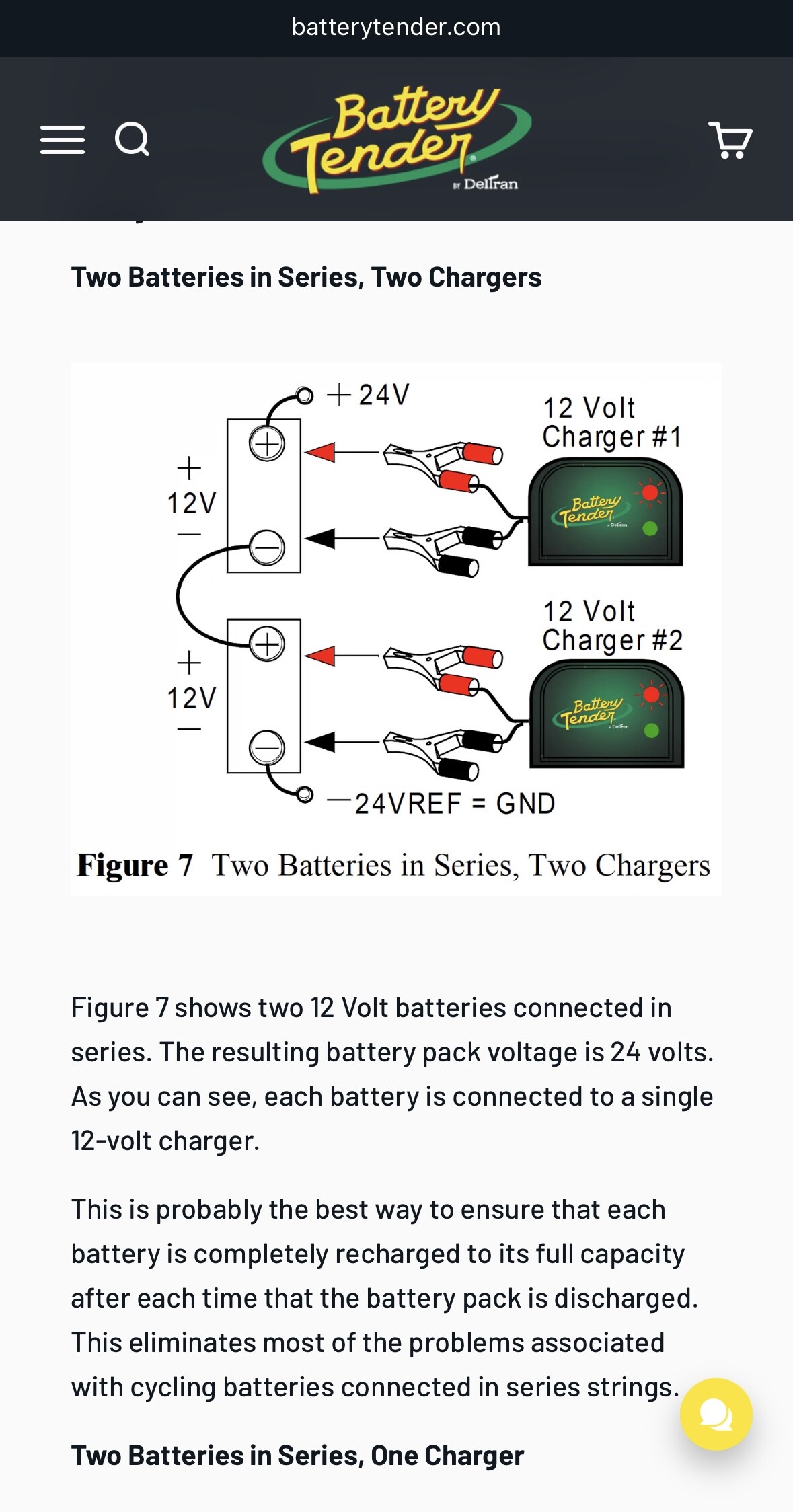

Hi, I have 3 lithium’s in series to make 36v. I know I can get a NOCO 3 bank charger from the states that will charge each of them individually. However I would prefer to use victron and am wondering if I can just buy 3 blue smart chargers and connect them to each battery and charge without disconnecting the series.
I am thinking that so long as I fully charge them it should remain mostly in balance, I do have victron balancers I can use but don’t know if that’ll work very well with the individual chargers.
I found this info on one website which would suggest it works but otherwise haven’t found much. Any help appreciated. Cheers
