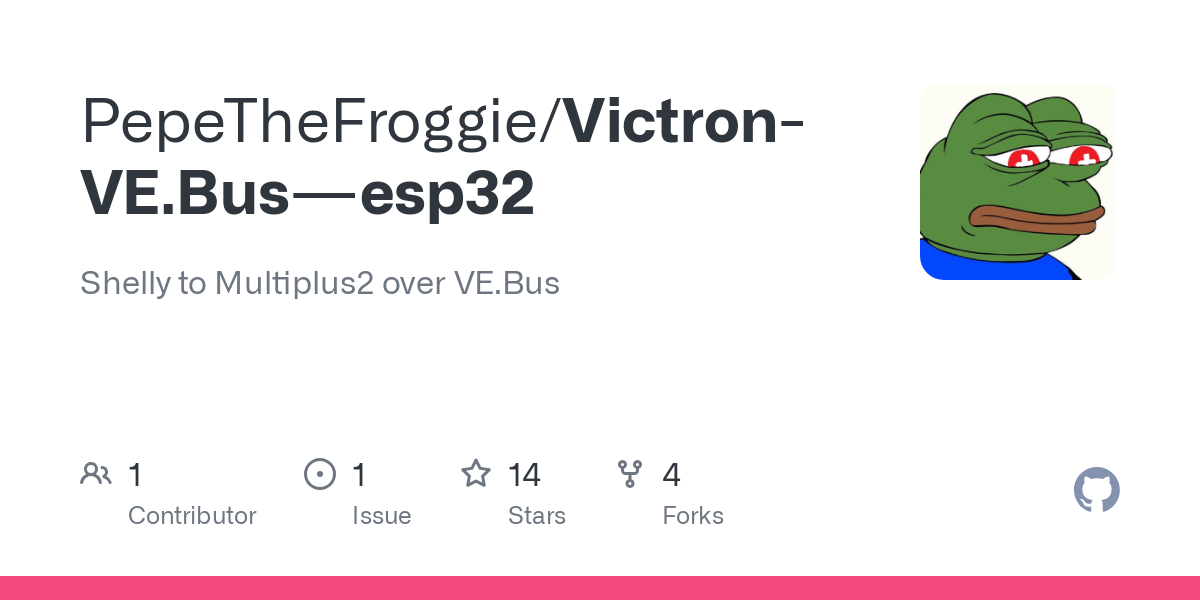

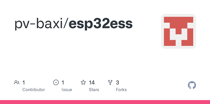

if its the git repo I think you were looking at their are 2x branches , I will dig it up latter on
other esp projects
and its a fork of

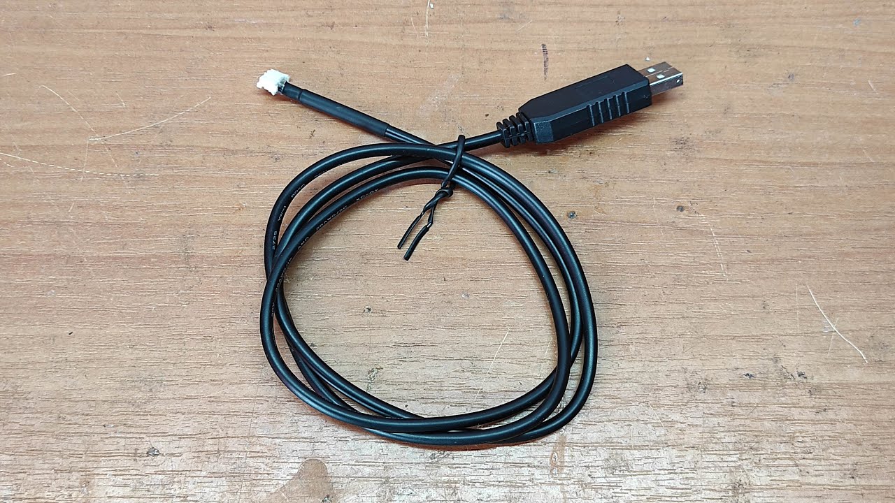

the other way is to just make a usb cable , which is what I do more stable then having yet another wifi device using up IP adresses
To make your own VE.Direct to USB cable, you’ll need a USB to UART TTL adapter, a JST connector compatible with VE.Direct devices, and some basic soldering skills. You may also want to include a digital isolator for safety and reliability.
  • USB to UART TTL adapter (e.g., PL2303HX or PL2303TA)
  • 2.0mm JST or PH connector with 4 pins
  • Digital isolator (e.g., ADUM1201)
    (optional but recommended also comes with headers you can use with a PH to Dupont cable )
  • Connect the JST connector to your VE.Direct device.
  • Connect the USB end to your computer.
  • Use Victron’s VE.Direct software to check for communication.
Important Considerations:
  • Digital Isolation:
Using a digital isolator is highly recommended to prevent potential damage to your devices and ensure electrical safety.
