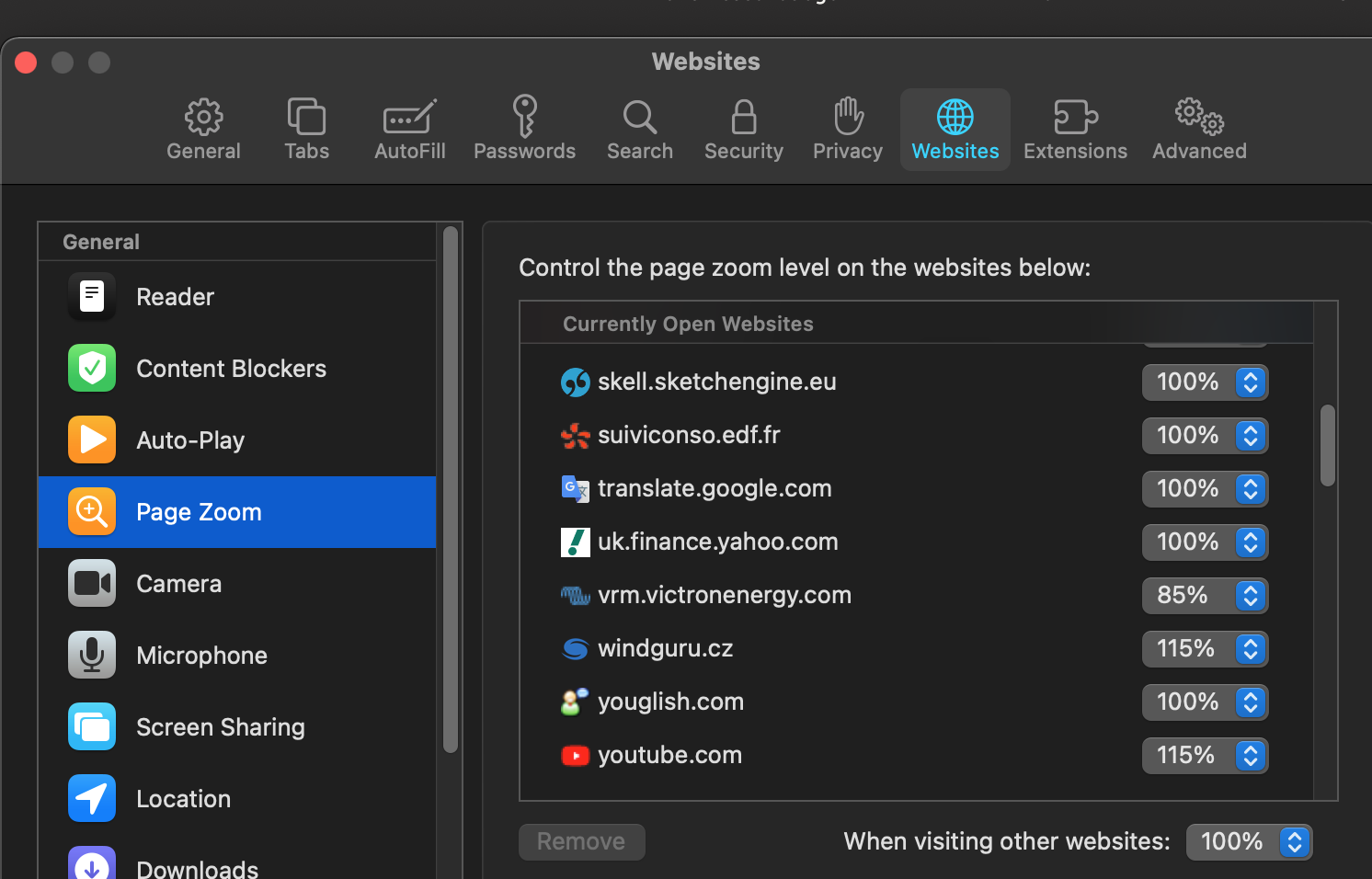

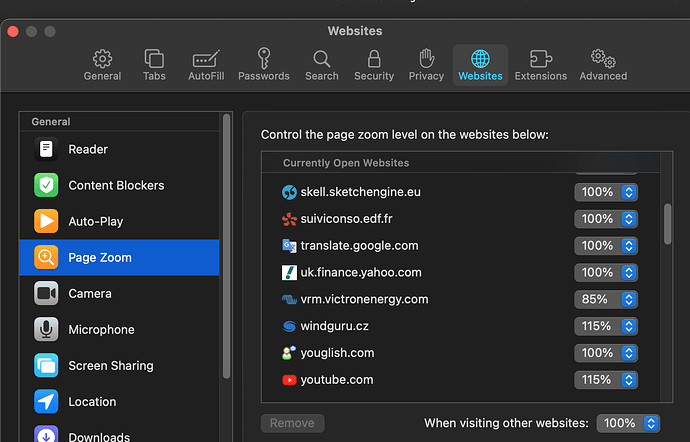

Thanks Jarco for the hints.
It’s not linked to accessibility but in Preferences with Page zoom option set at 85% it causes issue. At 100% it works fine.
Thanks again for helping me sorting this out.
Philippe
