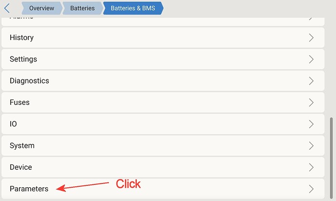

The parameters page is on the Cerbo
Cerbo menu > settings > Device list > Batteries (name will be what you have called them) > Parameters.

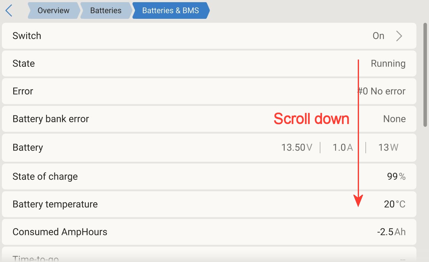

Note, the list under batteries is very large and you will have to scroll down to the bottom of the list.
You see this locally on the touch screen or on remote console through VRM. There is lots of info displayed on the Cerbo for the batteries.

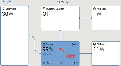

The other way to get to all the battery info on the Cerbo is from the overview page, click on the battery icon, then choose your lithium batteries from the list.
